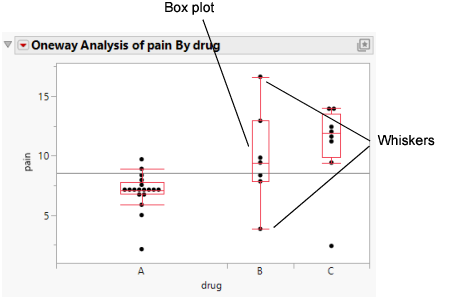

Figure 4.18 Example of Side-by-Side Box Plots

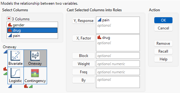

3. Select pain and click Y, Response.
4. Select drug and click X, Factor.
Figure 4.19 Fit Y by X Window
Fit Y by X Window
5. Click OK.

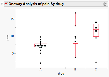

Figure 4.20 Side-by-Side Box Plots

The box plots in Figure 4.20 show these answers:
• There is evidence to believe that patients on drug A feel less pain because the box plot for drug A is lower on the pain scale than the others.
• Drug B appears to have higher variability than drugs A and C because the box plot is taller.
There is one point for drug C that is much lower than the other points for drug C. Hover over the lower point to see that it is row 26 of the data table. That point appears to be more similar to the data in drug groups A or B. The information in row 26 deserves investigation. There might have been a typographical error when the data was recorded.
