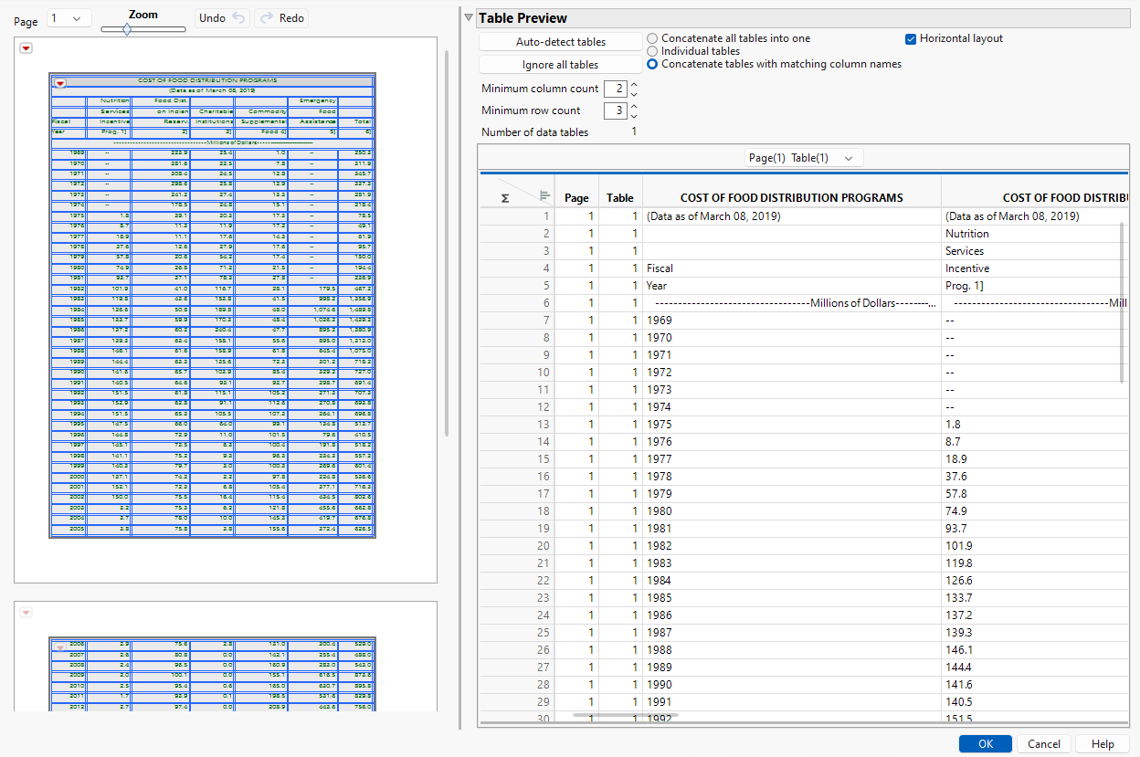

1. Select File > Open and select PDF Files from the list next to File name.
2. Navigate to the JMP Samples/Import Data folder and double-click Food Distribution.pdf.
3. In the PDF Import Wizard, a preview of the PDF file is shown on the left side of the window.
A preview of the data in a data table is shown on the right side of the window.
The PDF file consists of one table on each page.
Figure 3.21 Initial PDF File and Data Table Preview
Note the following items:
– There are seven rows at the top of the PDF file that you don’t want to import.
– There are footnotes in the last row of the PDF file that you also do not want to import.
4. In the corner of the first table, click the red triangle and select Number of rows to use as header > Specify rows.
5. Type 7 and click OK.
In the PDF file preview, the first seven rows are selected.
In the data table preview, the data begin on row 1.
6. In the PDF file preview, scroll down to page 2.

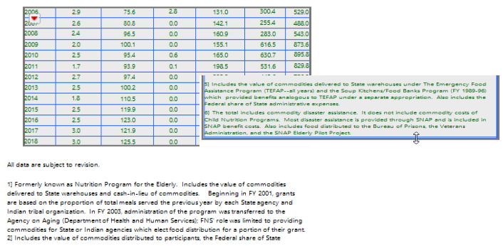

7. Drag the bottom of the PDF table upward until the footnotes are no longer selected (Figure 3.22).
Note: You can also simply delete the row from the final data table.
Figure 3.22 Dragging the Table to Remove Data

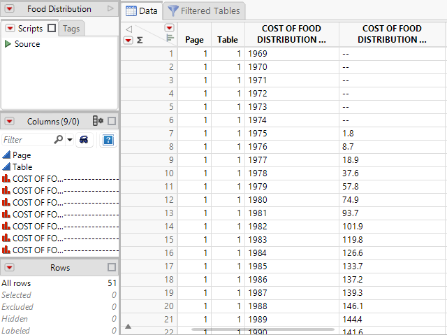

8. In the Table report on the right, select Concatenate all tables into one.
When you concatenate data tables, you combine rows from two or more data tables into one data table.
9. At the bottom, click OK.
The data is imported into a data table.
Figure 3.23 Final Data Table (Partial View)
