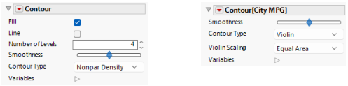

In Graph Builder, the Contour element (Image shown here) shows regions of density (or value contours when used with a Color variable). Density contours are useful when you have a scatterplot with many points where the mass of points makes it difficult to see patterns in density. Multiple contour types are available. The default is a smooth bivariate nonparametric density surface that is fit to reflect the density of the data points. The nonparametric density surface estimates the bivariate probability density function at each point, which provides a continuous analog of a bivariate histogram.

Contour Options
Figure 3.29 Contour Options for a Contour Plot or a Violin Plot
