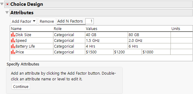

Define Factors and Levels
In this example, you load the factors from an existing table. When designing a new experiment on your own, enter the factors manually.
1. Select DOE > Consumer Studies > Choice Design.
2. Select Help > Sample Data Folder and open Design Experiment/Laptop Factors.jmp.
3. Click the Choice Design red triangle and select Load Factors.
Figure 18.4 Choice Design Window with Attributes Defined

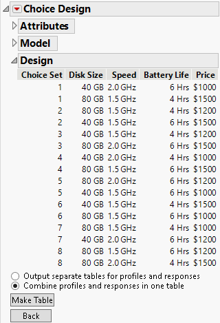

Figure 18.5 Pilot Design
Pilot Design
The single survey contains eight choice sets, each consisting of two laptop profiles.
5. Verify that the Combine profiles and responses in one table option is selected.
This places the choice sets and the survey results in the same table.
6. Click Make Table.
