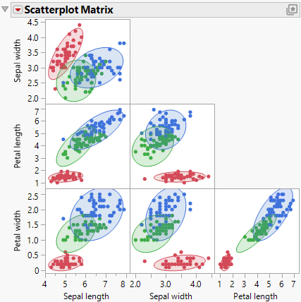

Before you perform a scatterplot matrix analysis, if your data does not have a grouping variable, you can create one by using the Cluster platform. Using the Iris.jmp data, assume that the Species column does not exist. You know that the data comes from three species of iris flowers, so you want to create three clusters within a group.
1. Using the Iris.jmp sample data table, select Analyze > Clustering > Hierarchical Cluster.
2. Select Sepal length, Sepal width, Petal length, and Petal width and click Y, Columns.
3. Click OK.
4. Click the Hierarchical Clustering red triangle and select Number of Clusters.
5. Type 3 to represent the three different Iris species.
6. Click OK.
7. Click the Hierarchical Clustering red triangle and select Save Clusters.
8. Close the Hierarchical Cluster report window, and look at the Iris.jmp data table.
You can see that a Cluster column has been added to the Iris.jmp data table.
9. Perform the Scatterplot Matrix analysis.
Follow the instructions in Example That Uses a Grouping Variable, but use Cluster as the grouping variable.
Figure 6.12 Example of a Scatterplot Matrix with a Cluster Variable
