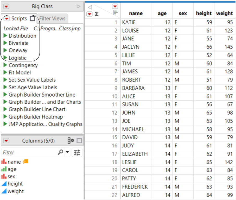

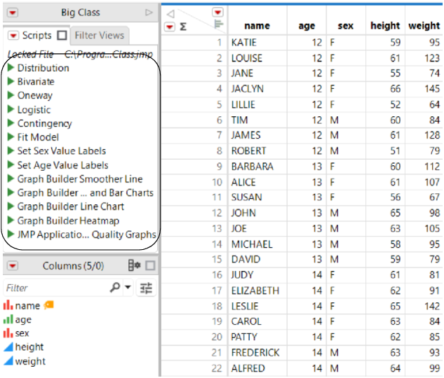

To automatically complete various analyses and tasks, you can create a JSL script and save it to the data table (Figure 4.66). For more information about writing data table scripts, see “Table Scripts” in the Scripting Guide.
Figure 4.66 Scripts Saved With the Data Table

The script is added to the bottom of the Table panel.

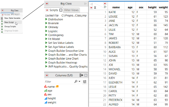

To add a script to a data table by using JSL

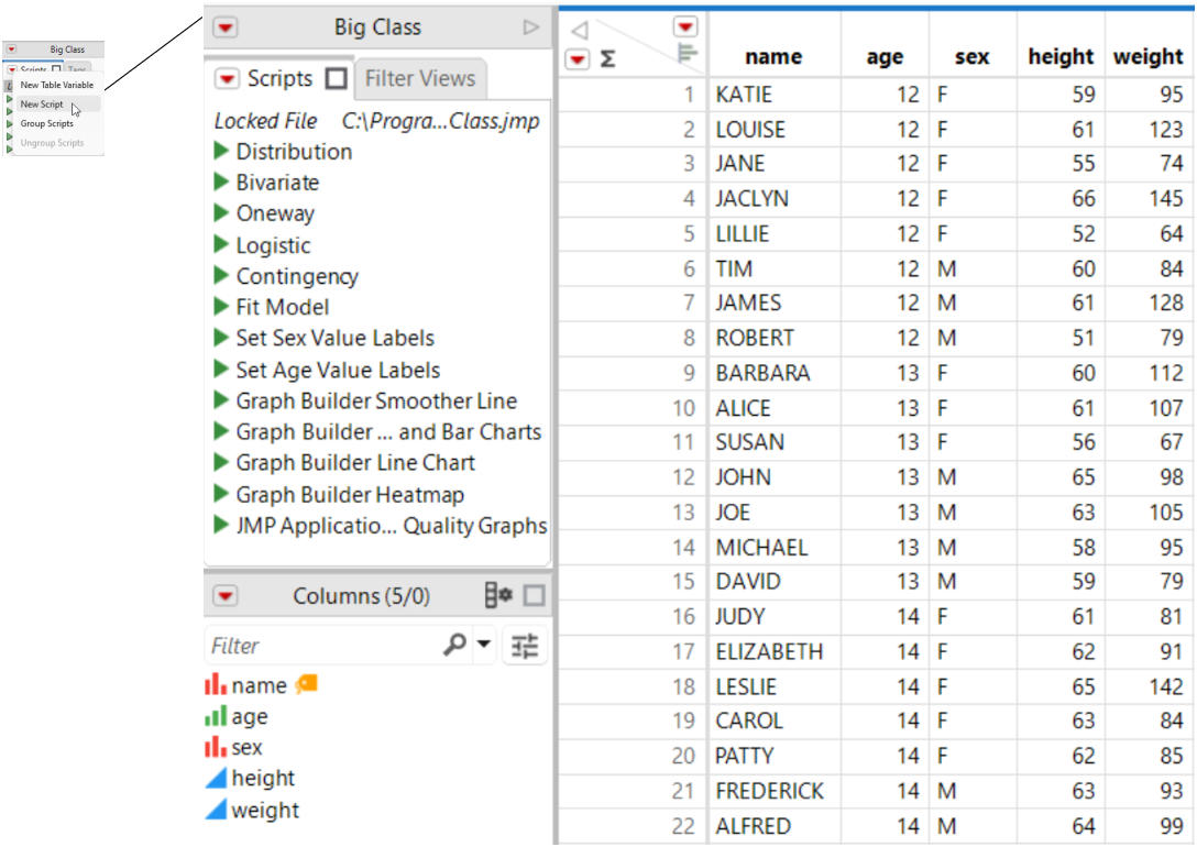

1. Click the red triangle to the left side of the Scripts panel.
Figure 4.67 Creating a Script
Creating a Script
2. Select New Script.
3. Give the script a name by entering it into the box beside Name.
4. Add the script by entering JSL code into the box beside Script.
