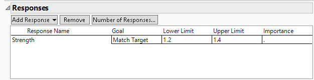

2. Double-click Y under Response Name and type Strength.
Note that the default Goal is Maximize. Your goal is to find factor settings that enable you to brew coffee with a target strength of 1.3, within limits of 1.2 and 1.4.
3. Click the default Goal of Maximize and change it to Match Target.
4. Click under Lower Limit and type 1.2.
5. Click under Upper Limit and type 1.4.
6. Leave the area under Importance blank.
Because there is only one response, that response is given Importance 1 by default.
Figure 3.4 Selection of Match Target as the Goal

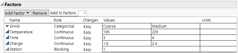

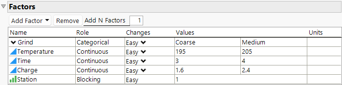

1. Click Add Factor > Categorical > 2 Level.
2. Type Grind over the default Name of X1.
Note that Role is set to Categorical, as requested. The Changes attribute is set to Easy by default, indicating that Grind settings can be reset for every run.
3. Click the default Values, L1 and L2, and change them to Coarse and Medium.
4. Type 3 next to Add N Factors. Then click Add Factor > Continuous.
5. Type the factor names and values over the default entries:
– Temperature (195 and 205)
– Time (3 and 4)
– Charge (1.6 and 2.4)
6. Click Add Factor > Blocking > 4 runs per block.
Recall that your run budget allows for 12 runs. You want to balance these runs among the three stations.
7. Type Station over the default Name of X5.
Notice that Role is set to Blocking and that only one setting for Values appears. This is because JMP cannot determine the number of blocks until the desired number of runs is specified. Once you specify the Number of Runs in the Design Generation section, JMP updates the number of levels for Station to what is required.
Figure 3.5 Completed Factors
Completed Factors
8. Click Continue.

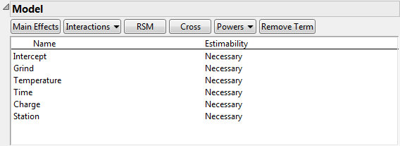

The Model section is where you specify your assumed model, which contains the effects that you want to estimate. See Specify. The list that appears by default shows all main effects as Necessary, indicating that the design is capable of estimating all main effects. Because your main interest at this point is in the main effects of the factors, you do not add any effects to the Model section.
Figure 3.6 Model with Main Effects Only

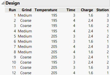

1. Click Make Design.
The Design and Design Evaluation sections are added to the Custom Design window. The Output Options panel also appears.
The Design section shows the design. If you did not set the random seed and number of starts as described in Steps to Duplicate Results (Optional), your design might be different from the one in Figure 3.8. This is because the algorithm used to generate the design begins with a random starting design.
Figure 3.8 Design for Coffee Experiment

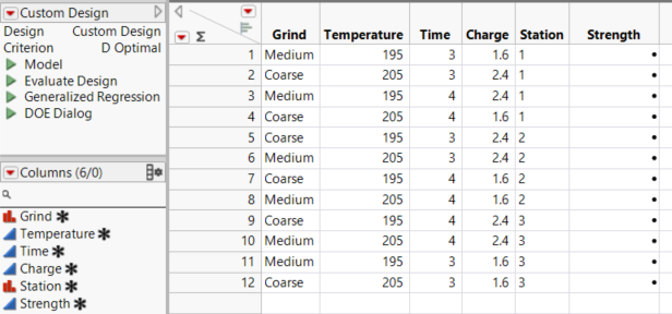

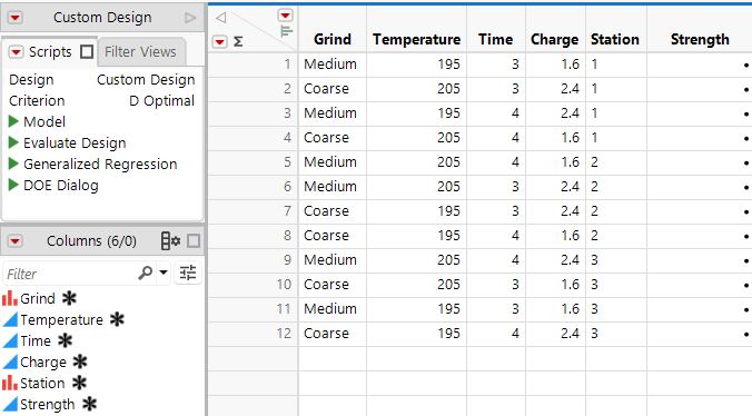

1. Click Make Table.
The data table opens. Keep in mind that, if you did not set the random seed and number of starts as described in Steps to Duplicate Results (Optional), your design table might be different. Your design table represents an alternative optimal design.
Figure 3.10 Custom Design Table
Custom Design Table
Note the asterisks in the Columns panel to the right of the factors and response. These indicate column properties that have been saved to the columns in the data table. These column properties are used in the analysis of the data. See “Factors” and “Factor Column Properties”.
