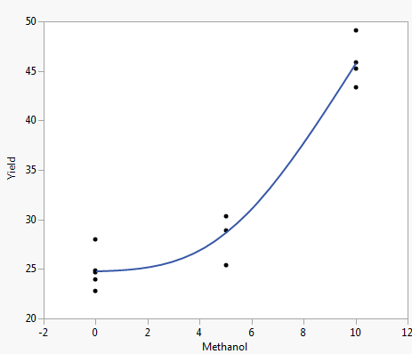

Figure 8.1 Plot of Response against Factor Values Showing Curvature
