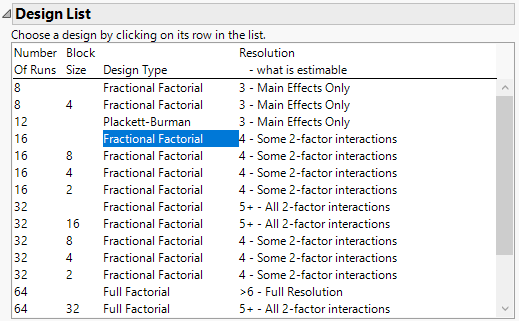

6. Select Choose from a list of fractional factorial designs.
7. Click Continue.
Potential designs appear in the Design List.
Figure 8.9 Screening Design List for Six Continuous Factors
8. Select the sixteen-run fractional factorial design with no blocks, shown highlighted in Figure 8.9.
9. Click Continue.

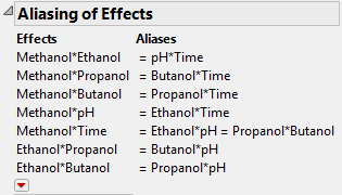

10. Open the Display and Modify Design > Aliasing of Effects section.
Figure 8.10 Aliasing of Effects for Fractional Factorial Design
The Aliasing of Effects section for the 16-run fractional factorial design shows that every two-factor interaction is confounded with at least one other two-factor interaction. In this fractional factorial design, the Ethanol*Time interaction is confounded with Methanol*pH. To determine which interaction is active, you need to run additional trials. If the factors had been entered in a different order, the Ethanol*Time interaction might have been aliased with two other two-factor interactions.
In the section Example of a Definitive Screening Design, you constructed a 17-run definitive screening design. The Color Map on Correlations for this DSD (Figure 8.4) shows that no two-factor interactions are confounded with any other two-factor interactions. For the fractional factorial design, there are seven instances of confounded two-factor interactions. If you suspect that there are active two-factor effects, the DSD is the better choice.
