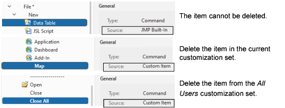

Rather than temporarily showing or hiding toolbars, buttons, menus, and menu items, you can delete items that you created to remove them permanently from JMP. The Source determines whether you can delete the item and which customization set contains the item. Figure 14.4 shows examples of customization Source types.
Figure 14.4 Examples of Customization SourcesĀ

3. Verify whether the item can be deleted, and change the customization set, if necessary.
4. Right-click the selected item and select Delete.
