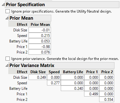

5. From the Untitled table, enter the values in the Estimate column into the Prior Mean section in the Choice Design window (Figure 18.9).
You can copy and paste the entire column from the Untitled table, click in the Disk Size text box under Prior Mean in the Prior Mean section, right-click, and select Paste.
6. From the Untitled table, enter the values in the Std Error^2 column into the diagonal entries in the Prior Variance Matrix section in the Choice Design window (Figure 18.9). Enter these one-by-one, rounded to three decimal places.
Figure 18.9 Prior Mean and Variance Information from Pilot Study
