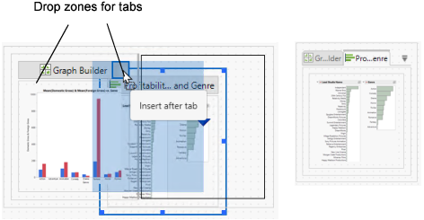

To help you rearrange reports while editing a dashboard, the outline around a report includes drop zones. When you drag the report into a different area of the box, a portion of the box is highlighted. The highlight shows where you can drop the box.
Figure 12.4 shows how to create tabbed reports. To put the Distribution report inside a tab, drag the report over the other report until the upper right corner of the bar chart report is highlighted. The Distribution report appears in a tab on top of the other report.
To remove a tabbed report, click the middle of the report and drag it outside of the tab.
Figure 12.4 Working with Tabbed Reports in Dashboard Edit Mode

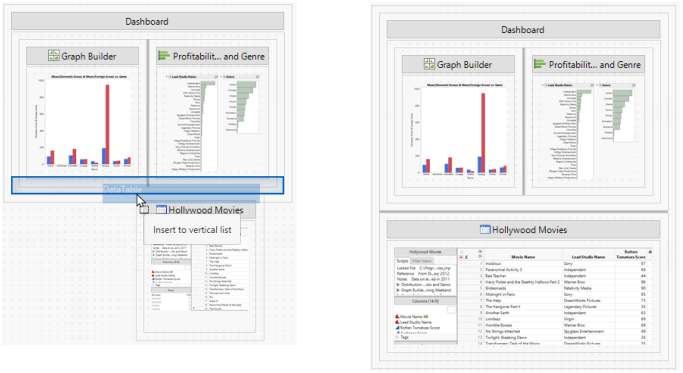

Figure 12.5 shows an example of placing a data table inside the bottom border of the report.
To display the data table below the report instead of inside it, drag the Data Table box onto the dashboard below the report. The box snaps inside the bottom border of the report.
Figure 12.5 Displaying a Data Table Inside a Report

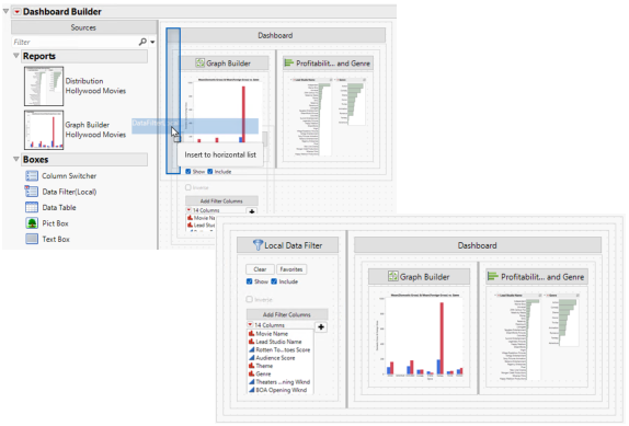

Figure 12.6 shows a data filter that appears to the left side of a report.
Figure 12.6 Adding a Data Filter to the Left Side of a Report
Tip: It can be difficult to tell which report a filter is acting upon or if a filter applies to all graphs. You can change the title of a data filter to indicate which graphs it impacts.

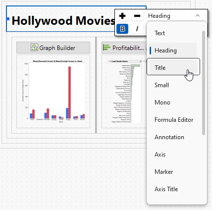

Format Text in a Dashboard
When you edit a dashboard, you can format text in a text box. Drag the text box to the dashboard and click the middle of the text box. Formatting options appear.
Figure 12.7 Formatting Options for a Text Box
