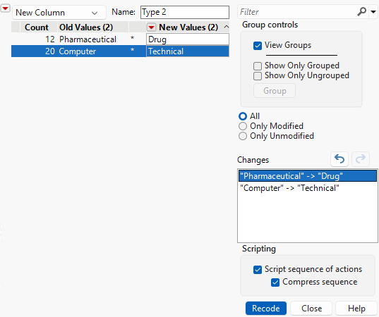

Recode Values
Use the recoding tool to change all of the values in a column at once. For example, suppose that you are interested in comparing the sales of computer and pharmaceutical companies. Your current company labels are Computer and Pharmaceutical. You want to change them to Technical and Drug. Going through each row of data and changing all the values would be tedious, inefficient, and error-prone, especially if you had numerous rows. Recode is a better option.
1. Select Help > Sample Data Folder and open Companies.jmp.
2. Select the Type column by clicking once on the column header.
3. Select Cols > Recode.
4. In the New Value column of the Recode window, type Technical in the Computer row and Drug in the Pharmaceutical row.
5. Select In Place from the New Column list.
6. Click Recode.
Figure 3.7 Recode Window
Recode Window
All cells are updated automatically to the new values.
