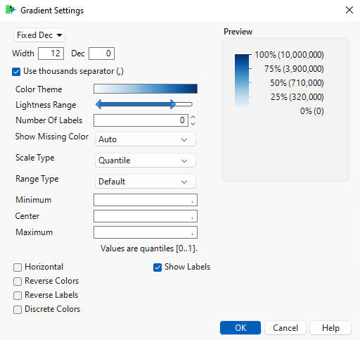

6. Customize the graph elements in the legend:
a. In the legend color bar, right-click and select Gradient.
b. Next to Width, type 12.
c. Next to Color Theme, click the color bar.
Under Sequential, click the second option (white to blue) and then click OK.
d. From the Scale Type list, choose Quantile.
Figure 4.12 Completed Gradient Settings Window
e. Click OK.

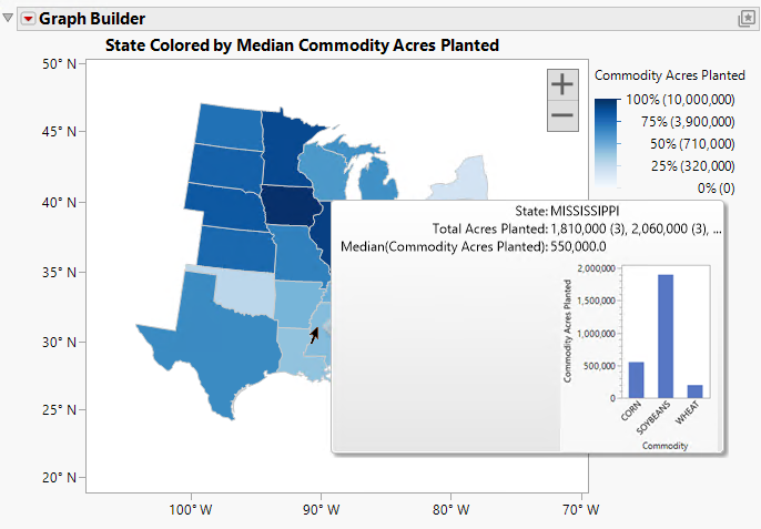

8. Right-click in the graph and select Hover Label > Bar.
This adds a bar chart hover graph.
9. Right-click in the graph again and select Hover Label > Hovel Label Editor.
10. Click the Thumbnail tab, select the Include X Axis Values and Include Y Axis Values check boxes, and then click OK.
When you hover over a state, you can see the proportions of the commodities that were grown in that state in a bar chart.
Note: For more information about Hover Labels, see “Customize Hover Labels in JMP Graphs” in Using JMP.
11. Click Done.
12. Hover over a state (in this case, Mississippi).
Figure 4.13 Completed Map Colored by Median Commodity Acres Planted
The coloring on the map highlights the states with the highest number of acres of wheat, corn, and soybeans. The dark blue states are known as America’s Breadbasket. The hover graphs enable you to explore the proportions of the three crops grown in a state. This example shows that in Mississippi, soybeans are the prominent crop.
