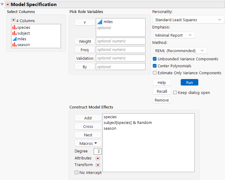

To specify the split plot model for this data, follow these steps:
1. Select Help > Sample Data Folder and open Animals.jmp.
3. Select miles and click Y.
4. Select species and subject and click Add.
5. In the Select Columns list, select species.
6. In the Construct Model Effects list, select subject.
7. Click Nest.
This adds the nested subject within species (subject[species]) effect to the model.
8. Select the nested effect subject[species].
9. Select Attributes > Random Effect.
This nested effect is now identified as an error term for the species effect and appears as subject[species]&Random.
10. In the Select Columns list, select season and click Add.
When you define an effect as random using the Attributes menu, the Method options (REML or EMS) appear at the top right of the Fit Model launch window. The REML option is selected as the default. The completed launch window is shown below.
Figure 4.38 Fit Model Launch Window
11. Click Run.

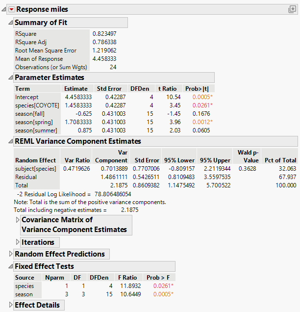

Figure 4.39 Partial Report of REML Analysis
In the Fixed Effect Tests table, note that both fixed effects, species and season, are significant. Both the type of animal and the season impacts the number of miles traveled. The REML Variance Component Estimates report shows estimates of the subject within species and residual variances.
