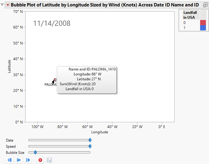

1. Select Help > Sample Data Folder and open Hurricanes.jmp.
2. In the Table panel, click the green triangle next to the Bubble Plot script.
3. Drag the Date slider to the right as shown in Figure 12.26.
4. Click the red dot to display the name of the hurricane.
The date appears in the upper left corner of the window. The red dot shows the location of Hurricane Paloma on November 14, 2008.
Figure 12.26 Bubble Plot of Hurricanes.jmp
Note that even though the location of the hurricane is plotted, it does not really tell you where it is. The axes information is there (27° North latitude and 86° West longitude), but you need a little more context. The hurricane is most likely over the middle of the Atlantic Ocean, but is it over a small island? This distinction could make a big difference, especially for the inhabitants of the small island. Obviously, a map in the background of your graph would add more detailed information.

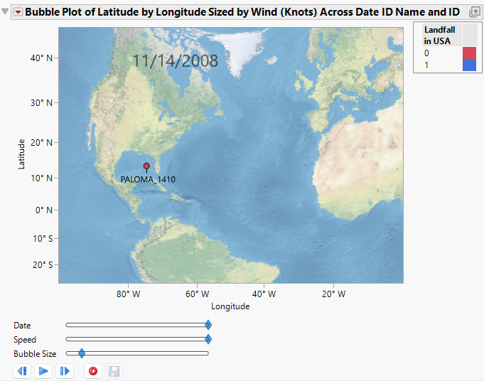

5. Right-click the graph and select Graph > Background Map.
The Set Background Map window appears (Figure 12.12).
6. Select Detailed Earth and click OK.
Figure 12.27 Bubble Plot of Hurricanes.jmp with Background Map
Now the coordinates make geographic sense. Click Run to view the animation of the hurricane data moving over the background map. Experiment with different options and view the displays. Adjust the axes or use the zoom tool to change what part of the world you are viewing. The map adjusts as the view does. You can also right-click the graph and select Size/Scale->Size to Isometric to make the graph’s aspect ratio proportional.

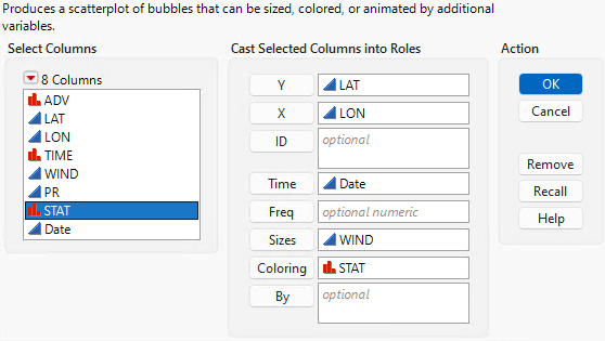

The next example uses the Katrina Data.jmp sample data table, which contains data on Hurricane Katrina, such as latitude, longitude, date, wind speed, pressure, and status. Adding a background map helps you see the hurricane’s path and its impact on land based on size and strength. A script has been developed for this example and is part of the data table.
1. Select Help > Sample Data Folder and open Katrina Data.jmp.
2. Select Graph > Bubble Plot.
3. Select LAT and click Y.
4. Select LON and click X.
5. Select Date and click Time.
6. Select WIND and click Sizes.
7. Select Stat and click Coloring.
Figure 12.28 Bubble Plot Setup of Katrina Data.jmp
8. Click OK.

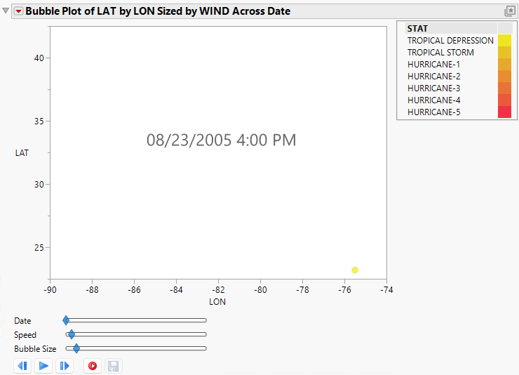

The following image appears. The yellow dot shows the location of Tropical Depression Katrina on August 23, 2005.
Figure 12.29 Bubble Plot of Katrina Data.jmp

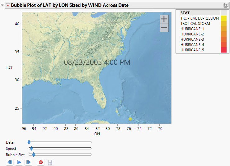

Notice that even though the location of the storm is plotted, the plot does not really tell you where the hurricane is. To add more context, add a map in the background.
9. Right-click the graph and select Graph > Background Map.
The Set Background Map window appears.
10. Select Detailed Earth and click OK.
Figure 12.30 Bubble Plot of Katrina Data.jmp with Background Map
Now the coordinates make geographic sense. You can edit the axes and the size/scale to change how the graph appears.

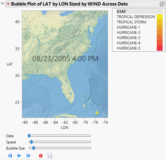

11. Right-click the X axis (LON) and select Axis Settings.
The X Axis Specification window appears.
12. Select Scale > Geodesic.
13. Select Format > Geographic > Longitude DMM.
14. Click OK.
15. Repeat the same for the Y axis (LAT) except select Format > Geographic > Latitude DMM.
16. Right-click the map and select Graph > Size/Scale > Size to Isometric.
Figure 12.31 Bubble Plot of Katrina Data.jmp with Background Map
Click Run to view the animation of the hurricane data as it moves over the background map. You can manipulate the speed and the bubble size. Experiment with different options and view the displays. Adjust the axes or use the zoom tool to change what part of the area you are viewing. Add boundaries to the states. The map adjusts as the view does.
