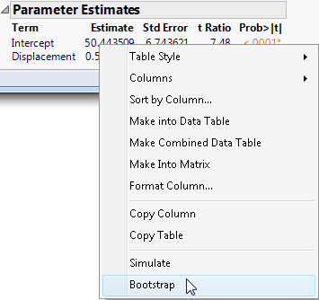

9. Right-click the Estimate column in the Parameter Estimates report and select Bootstrap.
Figure 11.2 The Bootstrap OptionĀ
The column that you right-click is relevant when the Split Selected Column option is selected. See Bootstrapping Window Options.

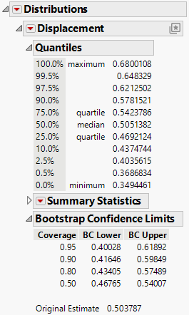

13. In the Bootstrap results table, run the Distribution script.
The Distribution report includes the Bootstrap Confidence Limits report.
Figure 11.3 Bootstrap ReportĀ
Bootstrap Report
The estimate of the slope (step 6) is 0.504. Based on the bootstrap results for 95% coverage, the company can estimate the slope to be between 0.40028 and 0.61892. When the displacement is changed by one unit, with 95% confidence, the horsepower changes by some amount between 0.40028 and 0.61892. The bootstrap confidence interval for the slope (0.400 to 0.619) is slightly wider than the confidence interval (0.425 to 0.583) obtained using the usual regression assumptions in step 7 and step 8.
