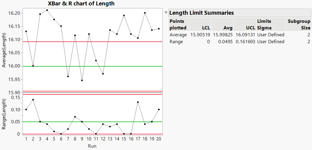

Figure 3.13 XBar and R Chart of Line Length with Historical Limits
Rather than calculating limits from the data, JMP used the historical control limits that you defined. In the Length Limit Summaries table, notice that the Limits Sigma now says User Defined. Many points now fall outside of the limits. Also, the averages are higher than those of the baseline process. This process appears different from the original process that was used to calculate the baseline control limits.

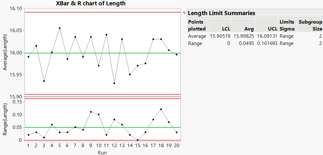

Figure 3.14 XBar and R Chart of Line Length with Excluded Data
JMP uses only the unexcluded rows (historical data) to create the control limits. The new data (excluded data) are plotted on the graph (dimmed), but these data were not used in any of the calculations. However, when you turn on the tests, all of the data is tested. The new data has many points that fall outside of the control limits and are flagged as failing Test 1 (point is more than 3σ from the average).

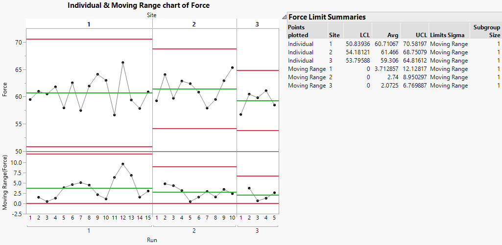

Figure 3.15 Baseline Control Chart for Existing Data

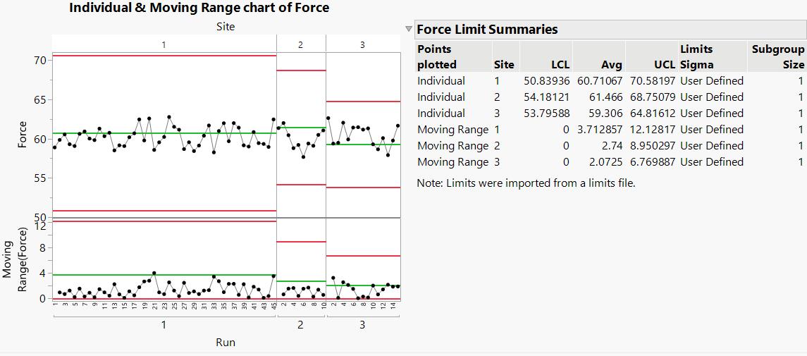

8. Click the Control Chart Builder red triangle and select Limits > Get Control Limits. Open the limits table that you saved in step 2.
This applies the historical limits to the new data in the Control Chart Builder report.
Figure 3.16 Control Chart for New Data Based on Historical Limits
Now you can see how the new data (after the process change) compare with the historical process limits (before the process change). None of the points fall outside of the control limits for either the location or dispersion chart. The goal was to reduce variability. Looking at the moving range chart, you can see that most points fall below the average line. For sites 1 and 2, it is clear that the variability of force needed to break the bond between pages and the book spine has been decreased. The decrease at Site 3 is not as strong as at sites 1 and 2. The improvements to the printing process appear to have succeeded in reducing the variability.
