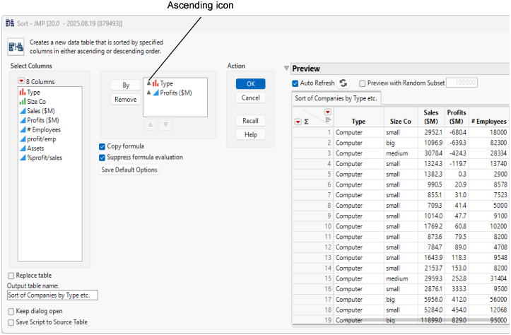

At this point, both variables are set to be sorted in ascending order. See the ascending icon next to the variables in Figure 3.29.
Figure 3.29 Sort Ascending IconĀ
Sort Ascending Icon

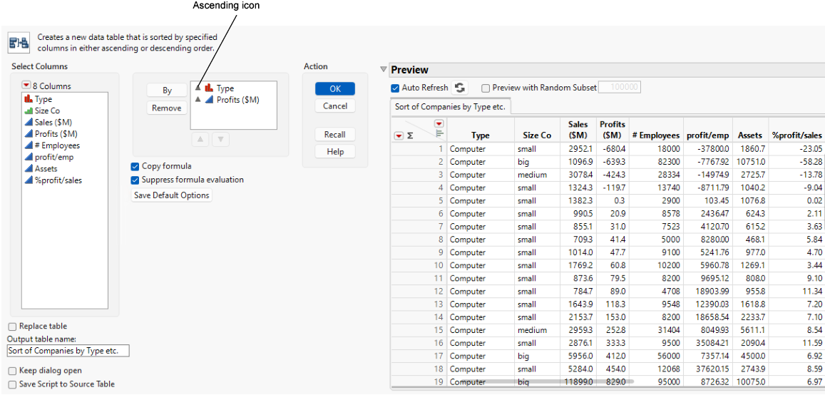

5. To change Profits ($M) to sort in descending order, select Profits ($M) and click the descending button.
Figure 3.30 Change Profits to DescendingĀ
The icon next to Profits ($M) changes to descending.
