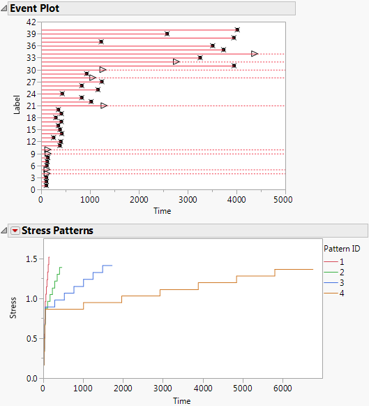

The initial report contains the Event Plot and a plot of the defined stress patterns. All four stress patterns increase the stress level quickly over the first 40 time units, after which they increase at much different rates.

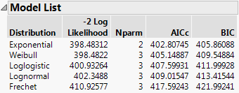

From the Model List report, you determine that the best fitting distribution is the Exponential distribution.

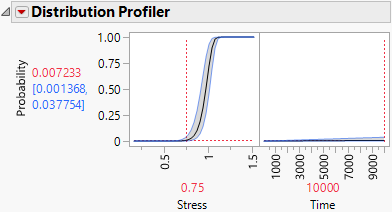

18. In the Distribution Profiler report, set the current value of Stress to 0.75.
19. Set the current value of Time to 10000.
Figure 7.4 Distribution Profiler for Exponential Distribution at Specified Settings
Figure 7.4 shows that the predicted probability of failure for a test unit under constant stress of 0.75 at 10000 time units is 0.007233, with a 95% confidence interval of 0.001368 to 0.037754.
