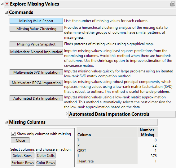

4. Click OK. Select the Show only columns with missing check box.
Figure 23.2 Missing Value ReportĀ
The Missing Columns report shown in Figure 23.2 indicates that only five columns have missing data. Out of a total of 452 rows, Column J has 376 missing values. Because it is largely missing, imputed values might not result in a meaningful analysis. For such data, you could explore a model using the Informative Missing option for Column J in a platform that supports the Informative Missing option.

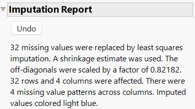

Figure 23.3 Imputation ReportĀ
Imputation Report
The Imputation Report indicates how many missing values were imputed and the specific imputation details. No missing data remain in the four columns that had missing values.
