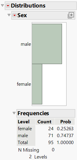

2. Select Analyze > Distribution.
3. Select Sex and click Y, Columns.
4. Click OK.
Figure 12.1 Distribution of Sex in Lipid Data.jmp
Figure 12.1 illustrates the distribution of Sex in the data set. Notice that there is not an equal proportion of males and females represented. Because there are fewer females within the data, you want to be sure to balance the sexes across the validation and training sets.

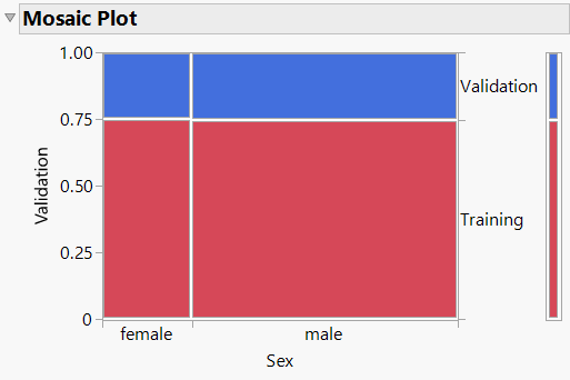

A Validation column is added to the data table. You can explore the distribution of the validation and training sets by creating a Mosaic Plot.
10. Select Analyze > Fit Y by X.
11. Assign Validation to Y, Response, and Sex to X, Factor.
12. Click OK.
Figure 12.2 Distribution of Sex across Validation and Training Sets
Figure 12.2 illustrates the distribution of Sex across each of the validation and training sets. Note that about 75% of both females and males are in the training set and about 25% of both females and males are in the validation set.
