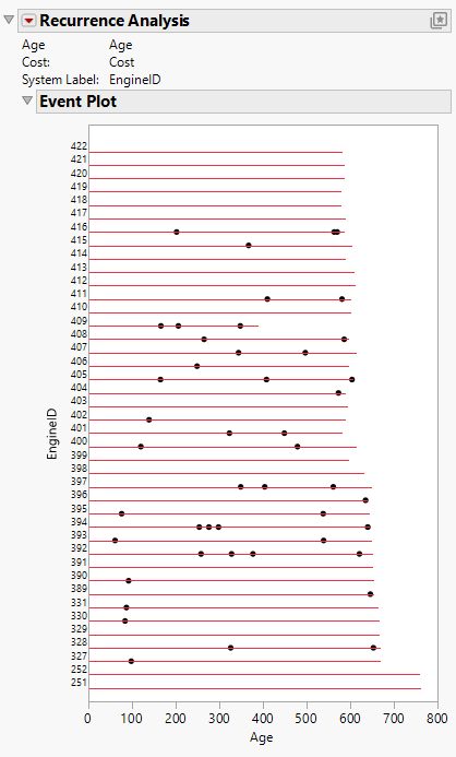

Figure 11.2 Event Plot for Valve Seat Replacements
The event plot in Figure 11.2 shows a timeline for each unit. There are markers at each time of repair, and each line extends to that unit’s last observed age. For example, unit 409 was last observed at 389 days and had three valve replacements.

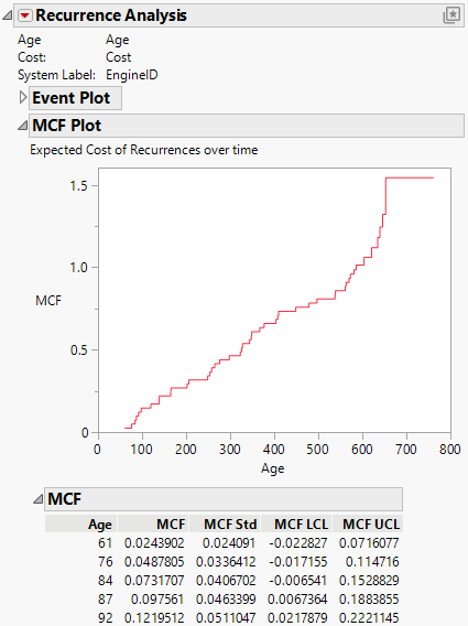

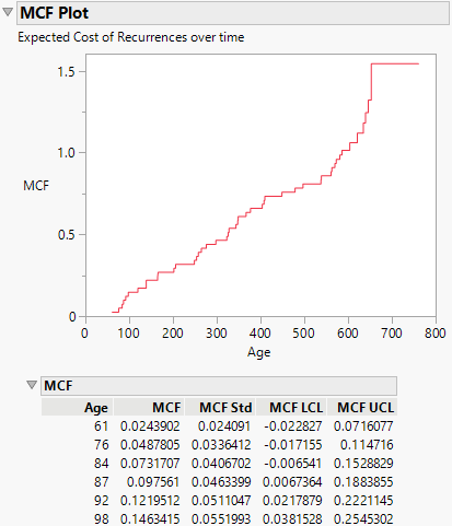

Figure 11.3 MCF Plot and Partial Table for Recurrence Analysis
The MCF plot in Figure 11.3 shows the sample mean cumulative function. For each age, this is the nonparametric estimate of the mean cumulative cost or number of events per unit. This function goes up as the units get older and total costs grow. The MCF plot shows that about 580 days is the age that averages one repair event.
