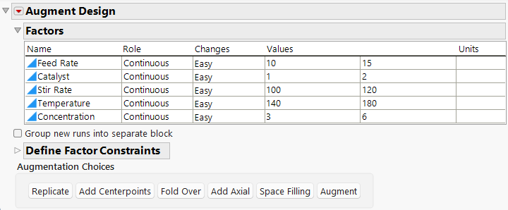

4. Select Feed Rate, Catalyst, Stir Rate, Temperature, and Concentration, and click X, Factor.
5. Click OK.
Figure 6.2 Factors for the Reactor Example
Note: You can select Group new runs into separate block to add a blocking factor to any design. However, recall that this example estimates all two-factor interactions in 16 runs, and that cannot be done when there is an additional blocking factor in the model.
6. Click Augment.

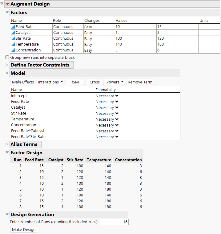

The model shown in Figure 6.3 is defined using the Model script in the data table. With 8 runs, you can estimate up to 7 effects. The model in the script contains all 5 main effects and two interaction terms. All terms are defined as necessary for the model. For more information about effect estimability, see “Model”.
Figure 6.3 Initial Augment Design Platform
7. In the Model section, select Interactions > 2nd.
This adds all the two-factor interactions to the model. The minimum number of runs given for the specified model is 16, as shown in the Design Generation text edit box.

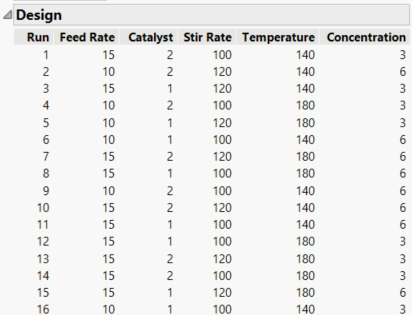

11. Click Make Design.
12. Click the Design disclosure icon to view the design.
Figure 6.4 16 Run Augmented Design
13. Click Make Table to generate a design table containing the original design with results and the augmented runs.

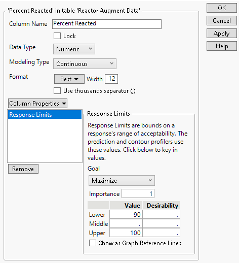

You want to maximize Percent Reacted. Note that the column’s Response Limits column property in this sample data table is set to Maximize. The lower and upper limits are set to 90 and 100, respectively.
Figure 6.5 Response Limits Column Property for the Percent Reacted Column

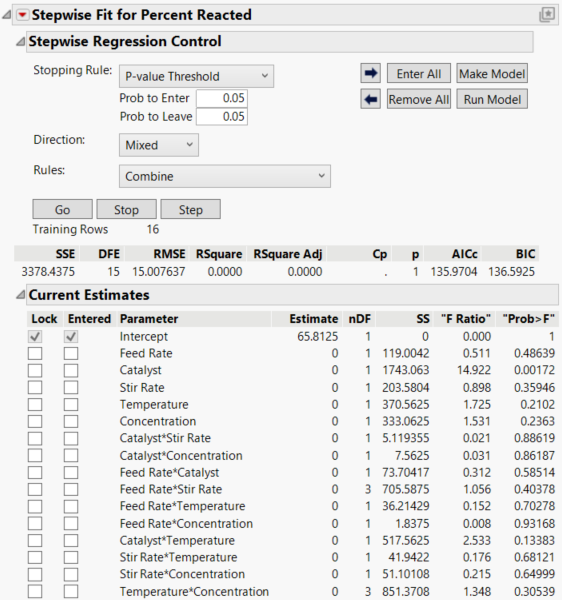

3. Change the fitting personality from Standard Least Squares to Stepwise and then click Run.
4. In the Stepwise Regression Control panel, select P-value Threshold from the Stopping Rule menu and Mixed from the Direction menu. Enter 0.05 for the Prob to Enter and 0.05 for the Prob to Leave.
Figure 6.6 Completed Stepwise Model
5. Click Go.
Stepwise regression, using a p-value based search, results in a model with three main effects and two interaction terms. Click Make Model on the Stepwise Regression Control panel.

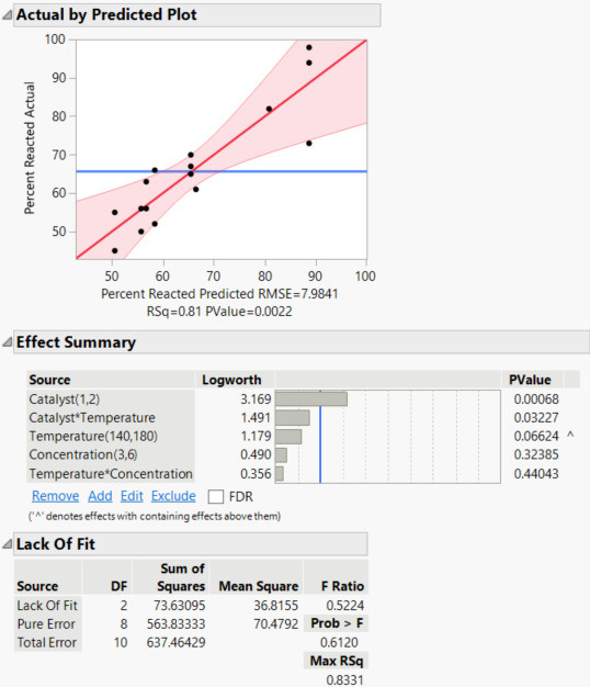

6. Click Run.
Figure 6.7 Prediction Model Analysis of Variance and Lack of Fit Tests
The Actual by Predicted Plot indicates that the overall model is significant (PValue = .0022). Both the Actual by Predicted Plot and the Lack of Fit tests show no evidence of model misspecification. The Effect Summary report shows that Catalyst is the most significant effect.

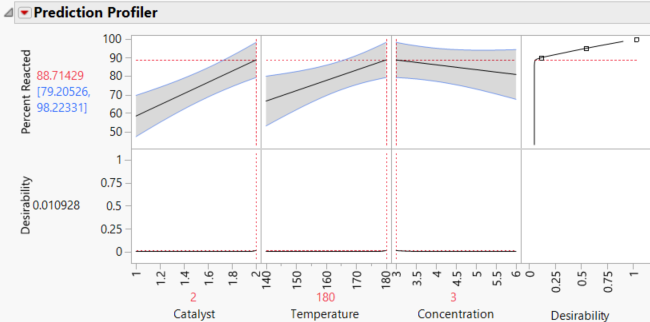

7. Click the Prediction Profiler red triangle and select Optimization and Desirability > Maximize Desirability.
Figure 6.8 Maximum Percent Reacted
The prediction profile plot shows that the maximum percent reaction occurs at high Catalyst and Temperature and low Concentration. At these extreme settings, the estimate of Percent Reacted is 95.7. The desirability profiles flatten in regions where the predicted response falls outside of the response limits.
