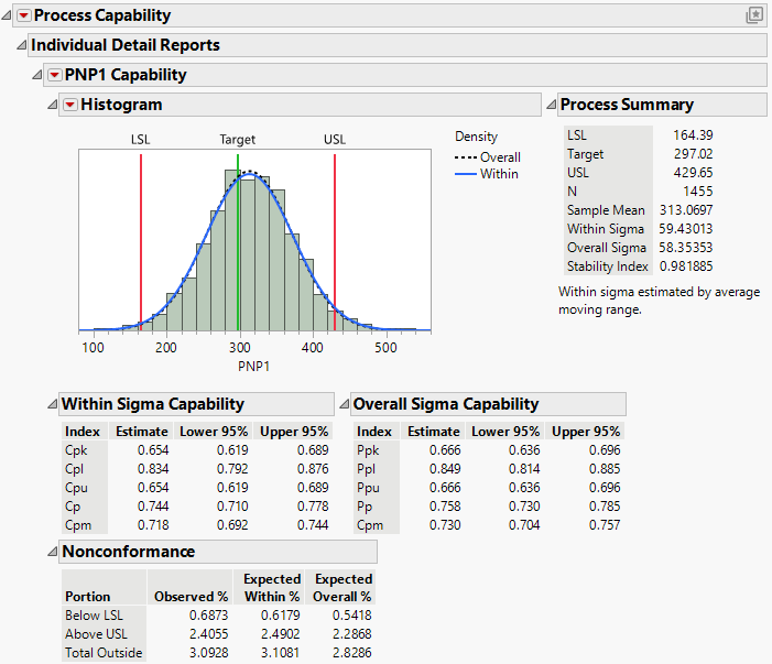

Normal Distributions
Figure 9.14 shows the Individual Detail Report for PNP1 from the Semiconductor Capability.jmp sample data table as described in Example of the Process Capability Platform with Normal Variables.
Figure 9.14 Individual Detail Report
The Individual Details report for a variable with a normal distribution shows a histogram, process summary details, and capability and nonconformance statistics. The histogram shows the distribution of the values, the lower and upper specification limits and the process target (if they are specified), and one or two curves showing the assumed distribution. The histogram in Figure 9.14 shows two normal curves, one based on the overall estimate of standard deviation and the other based on the within-subgroup estimate.
When you fit your process with a normal distribution, the Process Summary includes the Stability Index, which is a measure of stability of the process. The stability index is defined as follows:
(Overall Sigma/Within Sigma)
If Calculate Between-and-Within Capability is specified for a process in the launch window, the stability index for that process is defined as follows:
(Overall Sigma/Between-and-Within Sigma)
A stable process has stability index near one. Higher values indicate less stability.

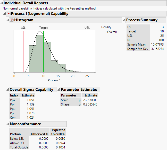

Nonnormal Distributions
Note: Capability indices based on within-subgroup variation and stability indices are not available for processes for which you have specified nonnormal distributions.
Figure 9.15 shows the Individual Detail Report for Process 1 from the Process Measurements.jmp sample data table as described in Example of the Process Capability Platform with Nonnormal Variables.
Figure 9.15 Individual Detail Report for Process 1
The report opens with a note summarizing the Nonnormal Distribution Options that you selected in the launch window.
The Individual Details report for a variable with a nonnormal distribution shows a histogram, process summary details, and capability and nonconformance statistics. The histogram shows the distribution of the values, the lower and upper specification limits and the process target (if they are specified). A curve showing the fitted distribution is superimposed on the histogram. If you selected a Nonparametric distribution, the curve shown in the histogram is the nonparametric density.
The report also shows a Parameter Estimates report if you selected a nonnormal parametric distribution or a Nonparametric Density report if you selected a Nonparametric fit. See Parameter Estimates and Nonparametric Density.

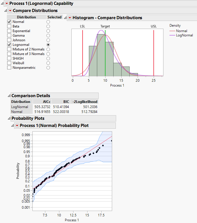

Compare Distributions
In the Process Capability platform, the Compare Distributions report enables you to compare and apply various distributional fits. Note the following:
• Your selected distribution is indicated in the Selected column.
• The report initially shows fit statistics for your Selected distribution and other fitted distributions in the Comparison Details report. If you selected Best Fit, the Comparison Details report initially shows statistics for all parametric fits.
• Check the distributions in the Distribution list that you want to compare.
– The probability density function for the best fitting distribution in each family that you select is superimposed on the histogram in the Histogram - Compare Distributions report.
– If the distribution is parametric, a row for that family containing fit results is added to the Comparison Details report.
– If Nonparametric is checked in the Distribution list, the Nonparametric Density report, showing the automatically selected kernel bandwidth, is added to the Compare Distributions report. See Nonparametric Density.
– You can change your selected distribution by selecting its radio button under Selected. The capability report is updated to show results for the selected distribution.
Figure 9.16 shows the Compare Distributions report for Process 1 in the Process Measurements.jmp sample data table. The Selected distribution, which is Lognormal, is being compared to a Normal distribution. The Comparison Details report shows fit statistics for both distributions.
To obtain probability plots, click the Compare Distributions red triangle and select Probability Plots. The points in the probability plot for the normal distribution in Figure 9.16 do not follow the line closely. This indicates a poor fit.
Figure 9.16 Compare Distributions with Probability Plot for Normal
