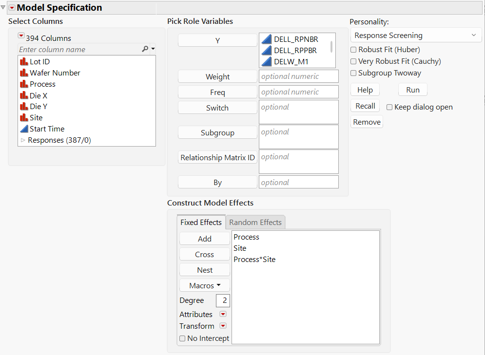

Launch Fit Response Screening by selecting Analyze > Fit Model and selecting Response Screening from the Personality list. You can specify models with fixed effects, random effects, or a combination of both using the tabs in the Construct Model Effects section.
Figure 25.6 Response Screening from the Fit Model Window in JMP Pro
The following column roles are unique to the Response Screening personality:
Image shown hereSubgroup
Specifies one or more subgroup variables. First, an analysis is performed for all rows. Then, separate analyses are performed for each level of each subgroup variable. All results are presented in a single table and report.
Image shown hereRelationship Matrix ID
Specifies the column that contains the names of the columns in a relationship matrix. Use this column role if you have an n-by-n relationship matrix that represents genetic relationships. This matrix can also be referred to as a kinship matrix. When you specify a Relationship Matrix ID column, the values in this column identify all of the columns to use and which rows go with which columns. Relationship matrices can be created using the Marker Relatedness platform. See “Marker Relatedness” in Life Sciences.

Fixed Effects Tab
Add all fixed effects in the Fixed Effects tab. Use the Add, Cross, Nest, Macros, and Attributes options as needed. For more information about these options, see “Model Specification” in Fitting Linear Models. Note that it is possible to construct a model that has no fixed effects.

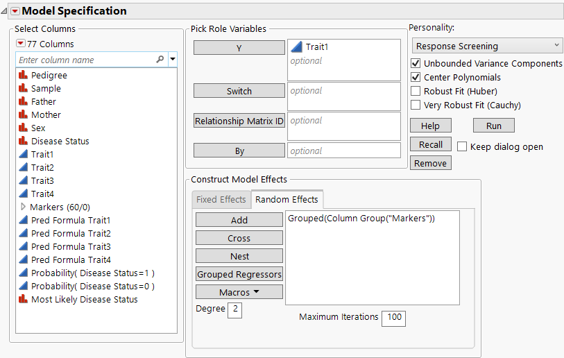

Image shown hereRandom Effects Tab
Specify traditional variance component models and models with grouped regressors using the Random Effects tab. For a traditional variance component model, specify terms such as random blocks, whole plot error terms, and subplot error terms using the Add, Cross, or Nest options. For more information about these options, see “Model Specification” in Fitting Linear Models.
Figure 25.7 Response Screening with Random Effects in JMP Pro
Use the Grouped Regressors button in the Random Effects tab to add a set of random continuous columns as a group effect that is associated with a single variance component. This approach is often used in genetics applications when there are a large number of genetic SNP or expression columns. The easiest way to add a grouped regressor is to first use Group Columns to group the columns of interested in the data table.
Note: If there are non-continuous factors in a group of regressors, the entire group is not included in the analysis.
When fitting models with random effects using the Response Screening personality, variance components are allowed to have negative estimates. The Unbounded Variance Components option specifies that variance components that have negative estimates are not reported as zero. This option is selected by default. It should remain selected if you are interested in fixed effects, because bounding the variance estimates at zero leads to bias in the tests for fixed effects. See “Negative Variances” in Fitting Linear Models for more information about the Unbounded Variance Components option.
