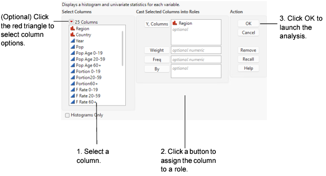

The launch window is your entry point into a platform, where you specify the columns to analyze. Figure 2.11 shows the Distribution launch window.
Figure 2.11 Launch Window Features
All launch windows have the following options in common:
Select Columns
Lists all of the variables in your current data table. Note the following points:
– Right-click the modeling type icon next to a column name to change the modeling type.
– Right-click the column name to create a transform column. See “Transform Columns in a JMP Platform”.
– Filter and sort the columns by using the options in the red triangle. See Column Filter Menu.
Cast Selected Columns into Roles
Moves selected columns into roles (such as Y, X, and so on). You cast a column into the role of a variable (like an actor is cast into a role). See Cast Selected Columns into Roles Buttons.
In the Graph Builder window, click the Dialog button or select Redo > Relaunch Analysis to show this panel.

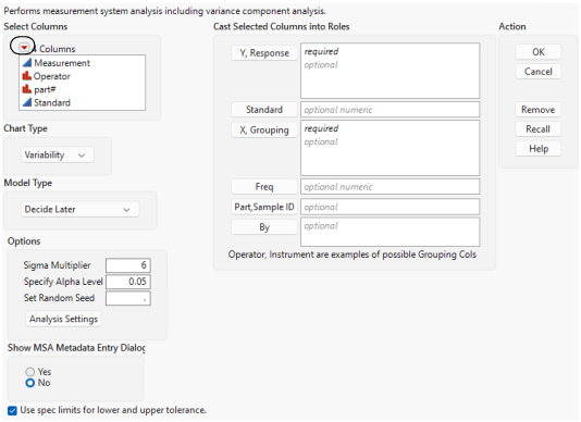

Column Filter Menu
A Column Filter menu appears in most of the launch windows. The Column Filter menu is found by clicking the red triangle in the Select Columns pane. Use these options to sort columns, show or hide columns, or search columns.
Figure 2.12 The Column Filter Menu
Reset
Resets the columns to its original list.
Show Filter
Opens a box in which you enter the column name that you want to find. Click the down arrow next to the box and select options to customize the filter.
