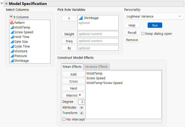

Launch the Loglinear Variance personality by selecting Analyze > Fit Model, entering one or more columns for Y, and selecting Loglinear Variance from the Personality menu.
Figure 11.3 Fit Model Launch Window with Loglinear Variance Selected
