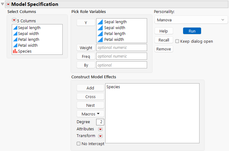

Launch the Manova personality by selecting Analyze > Fit Model, entering one or more columns for Y, and selecting Manova from the Personality menu.
Figure 10.3 Fit Model Launch Window with Manova Selected
