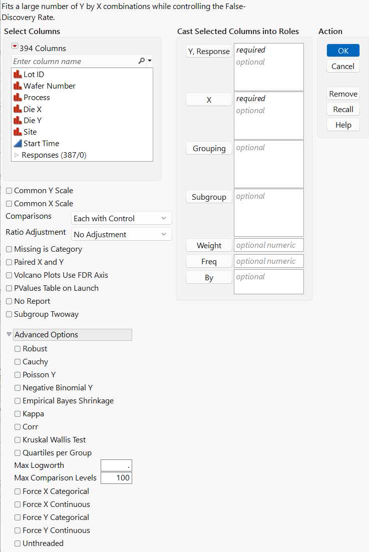

Launch the Response Screening platform by selecting Analyze > Screening > Response Screening.
Figure 25.4 Response Screening Launch Window
