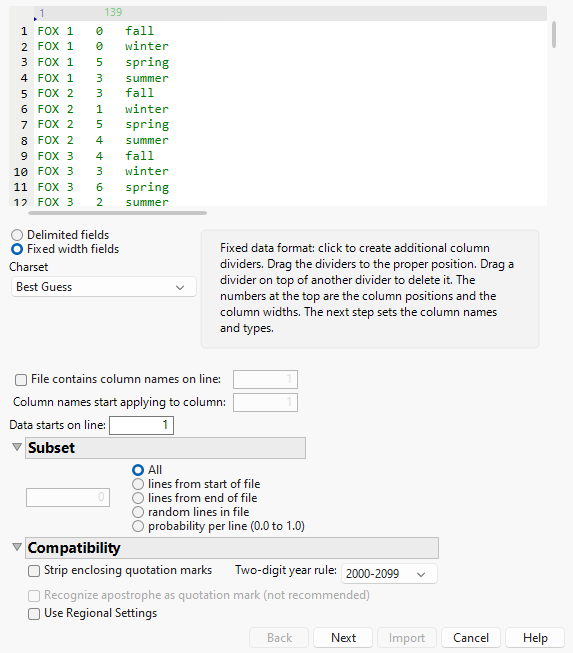

JMP detects the file’s structure and shows options for importing text with either delimiters or fixed-width fields. If JMP chooses the wrong file structure, click the Delimited fields or Fixed width fields radio button to import the data as the correct format. For example, the fixed-width window might appear when your file is actually delimited.
The text import wizard options are shown in Figure 3.14 and Figure 3.15.
Figure 3.14 Text Import Wizard for Fixed-Width Files

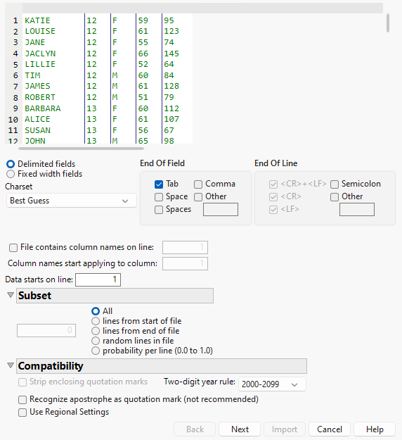

Figure 3.15 Text Import Wizard for Delimited Files

End of Field
(Available only in the Delimited Import window.) Select the check boxes beside the character that marks the end of a field. Alternatively, select the check box beside Other and enter a character if the appropriate character is not listed.
End of Line
(Available only in the Delimited Import window.) Select the check boxes beside the character that marks the end of a line (row). Alternatively, select the check box beside Other and enter a character if the appropriate character is not listed. Note that when JMP finds double quotation marks, the delimiter rules change to look for an end double quotation mark. Other text delimiters, including spaces embedded within the quotation marks, are ignored and treated as part of the text string.

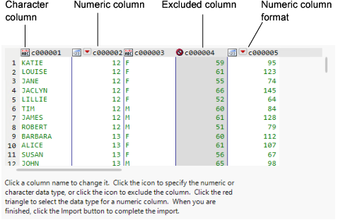

When you are finished selecting the settings, click Next. The next window shows each column’s modeling type. To change the default modeling types, perform one of the following actions:
• Click the data type button to change the data type from numeric (Image shown here) to character (Image shown here). Clicking the button cycles between the modeling type and exclude (Image shown here). Exclude means that the column is not imported.
• To change a numeric column’s data format, select the format from the red triangle menu.
• Click the column header to modify the text.
The top of the text import window shows a preview of the text file as it appears when the file is imported into a JMP data file. Click the Import button to import the data.
Figure 3.16 Text Import Wizard Window with Column Options
