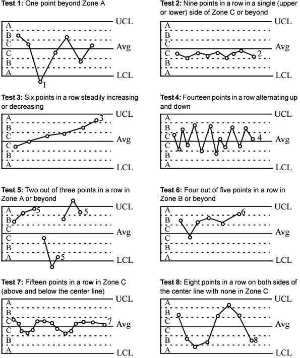

Table 3.8 lists and interprets the eight tests, and Figure 3.11 illustrates the tests. The following rules apply to each test:
• The area between the upper and lower limits is divided into six zones, each with a width of one standard deviation.
• The zones are labeled A, B, C, C, B, A with zones C nearest the center line.
• A point lies in Zone B or beyond if it lies beyond the line separating zones C and B. That is, if it is more than one standard deviation from the center line.
• Any point lying on a line separating two zones lines is considered belonging to the innermost zone. So, if a point lies on the line between Zone A and Zone B, the point is considered to be in Zone B.
• When a Phase variable is specified, the counts for each test are reset at the start of each phase.
Notes:
• Tests 1 through 8 apply to all Shewhart Variables chart types.
• Tests 1, 2, 5, and 6 apply to the upper and lower halves of the chart separately.
• Tests 3, 4, 7, and 8 apply to the whole chart.
• Once a runs test (one that is based on consecutive observations) is triggered, the counts do not reset to 0 when moving to the next sample.
• Runs tests handle excluded rows based on the setting of the Show Excluded Region and Test Excluded Subgroups options.
– By default, both options are selected, and the excluded rows are included in the runs tests calculations.
– If the Show Excluded Region option is selected and the Test Excluded Subgroups option is not selected, the excluded rows are treated as missing and the counts for the runs tests reset to 0 when moving to the next sample.
– If the Show Excluded Region option is not selected, the excluded rows are treated as if they are deleted.
• Tests 5 through 8 are not available for attribute charts.
See Nelson (1984, 1985) for further recommendations on how to use these tests.

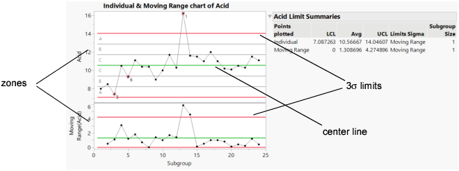

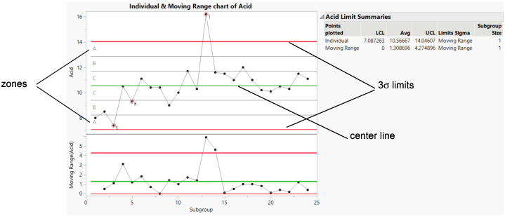

Figure 3.10 Zones for Western Electric Rules
Table 3.8 Description and Interpretation of Tests for Special Causes1
Test 1
One point beyond Zone A (upper or lower)
Detects a shift in the mean, an increase in the standard deviation, or a single aberration in the process. For interpreting Test 1, any dispersion chart (R, S, or MR) can be used to rule out increases in variation.
Note that if you hide the upper or lower control limits, the Test 1 option does not flag points that are associated with limits that are not shown on the control chart.
Test 2
Nine points in a row in a single (upper or lower) side of Zone C or beyond
Detects a shift in the process mean.
Test 3
Six points in a row steadily increasing or decreasing (anywhere on the chart)
Detects a trend or drift in the process mean.
Test 4
Fourteen points in a row alternating up and down (anywhere on the chart)
Detects systematic effects such as two alternately used machines, vendors, or operators.
Test 5
Two out of three points in a row in or beyond Zone A and the point itself is in or beyond Zone A; the two points must be on the same side (upper or lower)
Detects a shift in the process average or increase in the standard deviation. Any two out of three points provide a positive test.
Test 6
Four out of five points in a row in or beyond Zone B and the point itself is in or beyond Zone B; the four points must be on the same side (upper or lower)
Detects a shift in the process mean. Any four out of five points provide a positive test.
Test 7
Fifteen points in a row in Zone C, above and below the center line
Detects stratification of subgroups when the observations in a single subgroup come from various sources with different means. Also detects a reduction in variation.
Test 8
Eight points in a row on both sides of the center line with none in Zones C
Detects stratification of subgroups when the observations in one subgroup come from a single source, but subgroups come from different sources with different means.
1 Nelson (1984, 1985)
Figure 3.11 Illustration of Special Causes Tests1
