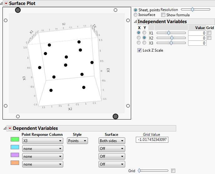

A central composite design (Figure 12.2) combines a two-level fractional factorial design and two other types of points:
• Center points, where all the factor values are set to the midrange value.
• Axial points, where one factor is set to a high or low value (an axial value) and all other factors are set to the midrange value.
Depending on your selections relative to axial points, a central composite design can have as many as five distinct settings for each factor and the axial points can extend beyond the specified range of the factors.
Figure 12.2 Central Composite Design for Three Factors
A Box-Behnken design (Figure 12.3) has only three levels per factor and has no design points at the vertices of the cube defined by the ranges of the factors. This type of design can be useful when you must avoid these points due to engineering considerations. But, the lack of design points at the vertices of the cube means that a Box-Behnken design has higher prediction variance, so less precision, near the vertices compared to a central composite design.
Figure 12.3 Box-Behnken Design for Three Factors
