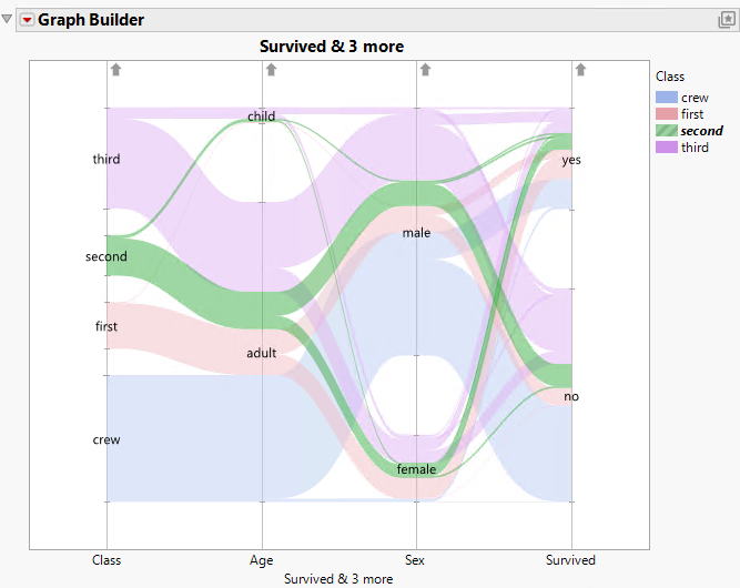

When all variables are categorical, there is a band for every combination of levels of the categorical variables. The bands split as they move from left to right. In the first interval that corresponds to a categorical variable, there is a band for every level of that categorical variable. In the last interval that corresponds to categorical variables, there is a band for every possible combination of the categorical variables.
Figure 3.42 Example of Categorical Bands by Using Titanic.jmp
In Figure 3.42, the band that contains all second-class passengers is selected. The parallel plot shows that most were adults, there were more males than females, and slightly fewer survived than did not survive.
