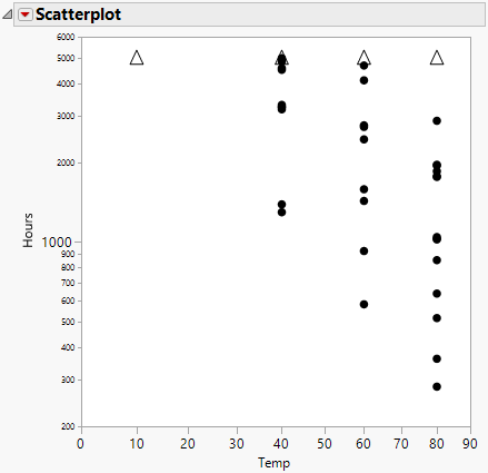

The scatterplot of the lifetime event versus the explanatory variable appears at the top of the Fit Life by X report. Table 5.2 indicates how each type of failure is represented on the scatterplot. To increase the size of the markers on the graph, right-click the graph, select Marker Size, and then select one of the marker sizes listed.
Figure 5.5 Scatterplot of Hours versus TempĀ
Table 5.2 Scatterplot Representation for Failure and Censored Observations
Event
failure
dots
right-censoring
upward triangles
left-censoring
downward triangles
interval-censoring
downward triangle on top of an upward triangle, connected by a solid line

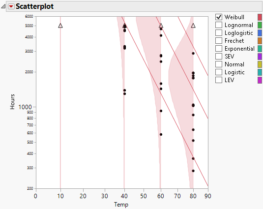

Figure 5.5 shows the initial scatterplot; Figure 5.6 shows the resulting scatterplot with the Show Density Curves and Add Quantile Lines options selected displaying the curves and the lines for the various Temp levels for the Weibull distribution. You can also view density curves across all the levels of Temp for the other distributions. These distributions can be selected one at a time or can be viewed simultaneously by checking the boxes to the left of the desired distribution name(s).
Figure 5.6 Scatterplot with Density Curve and Quantile Line OptionsĀ
