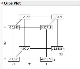

Figure 10.1 Results from a Fractional Factorial Design
