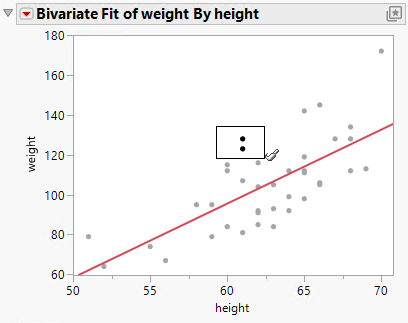

You can select all points that fall in a rectangular area by using the cursor. Click and drag the arrow to highlight points. Alternatively, you can use the brush tool. As you move the brush over the graph, points that fall within the rectangle are selected. Any points marked in the data table as hidden are not selected. See “Hide Rows in Data Tables”.

1. Click the brush tool (Image shown here) in the toolbar.
2. Click and hold the brush tool in a plot.
A rectangle appears.
3. Move the rectangle over points.
As the rectangle passes over the points, they appear highlighted both in the plot and in the active data table.
To keep all points selected as you move the brush tool over them, press and hold Shift before you click a point in the plot. The selected points are also selected in the data table.
Figure 9.31 Using the Brush Tool
4. Release the mouse. The points within the rectangle and the data table remain selected.
