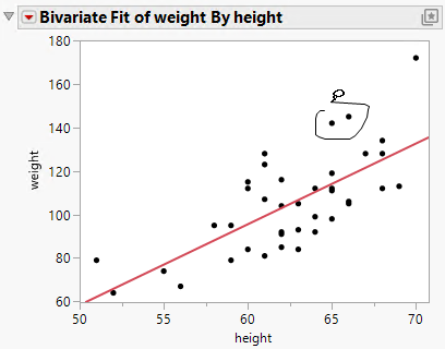

Figure 9.32 Using the Lasso Tool
4. Release the mouse.
JMP automatically closes the lasso and highlights the points within the enclosed area.
