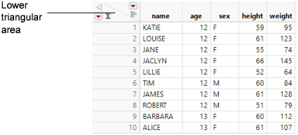

• Press Shift and click the lower triangular area in the data grid above the row numbers. Click again in the same area to deselect all rows (Figure 4.7).
• Press Esc to clear all highlighted areas in the data table.
Figure 4.7 Lower Triangular Area
