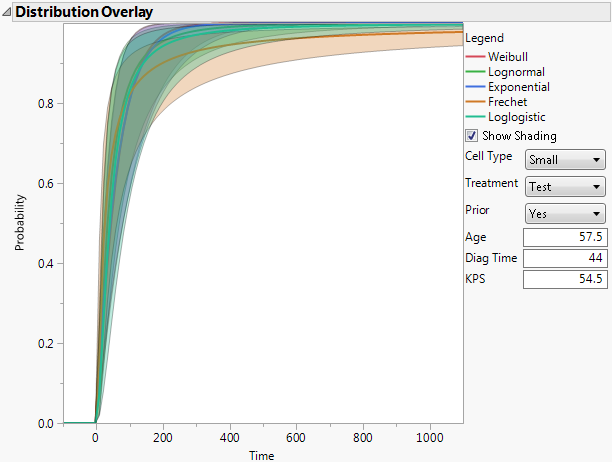

Both the Distribution Overlay and Quantile Function Overlay plots show curves for each of the fitted distributions overlaid on the same graph. By default, each curve has a shaded Wald-based confidence interval. To the right of each plot, there is legend, an option to show shading of confidence intervals, and controls that enable you to specify different values of the effects. Figure 6.6 shows an example of a Distribution Overlay plot.
Note: You can change the α level for the shaded confidence intervals by selecting Set Alpha Level from the red triangle menu in the Fit Model launch window. The default α level is 0.05.
Figure 6.6 Distribution Overlay Plot
