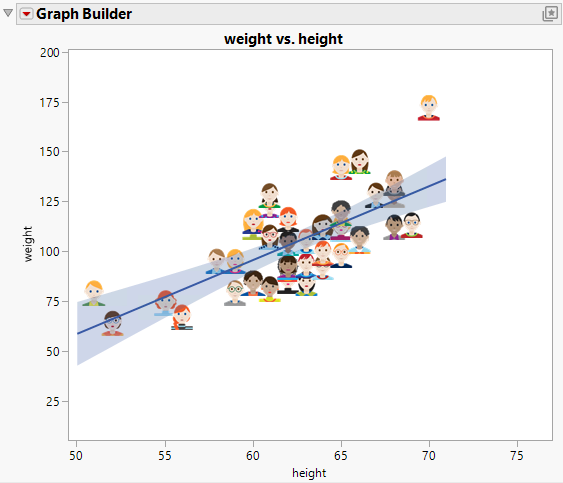

6. Create a graph that uses markers.
Figure 9.34 was created in Graph Builder.
7. (Optional) To resize the markers, right-click the graph, and select Graph > Marker Size (or right-click and select Marker Size in some platforms).
Medium markers are selected in this example.
8. Click the Graph Builder red triangle and deselect Show > Legend.
Figure 9.34 Images Used as Markers
