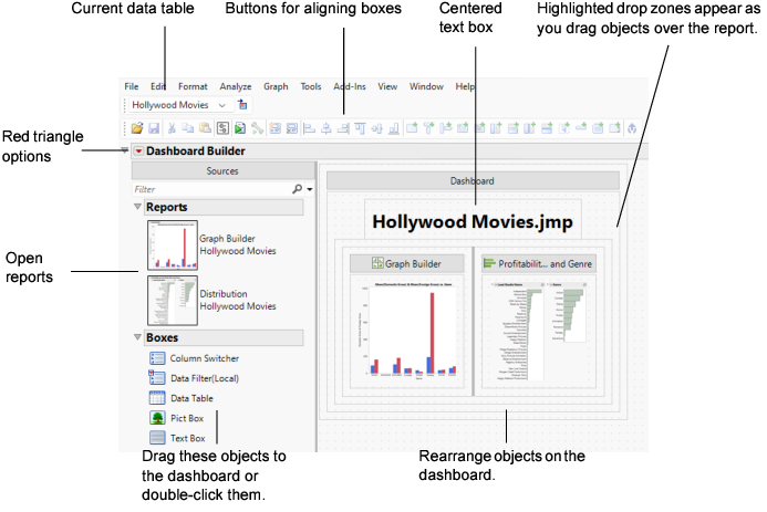

Figure 12.3 shows a dashboard in development. The two reports in the left pane were generated from the Hollywood Movies.jmp sample data table. Those reports were added to the right pane. “Hollywood Movies.jmp” is displayed in a text box that was added to the dashboard and centered by using the toolbar buttons.
Figure 12.3 The Dashboard Builder Window
