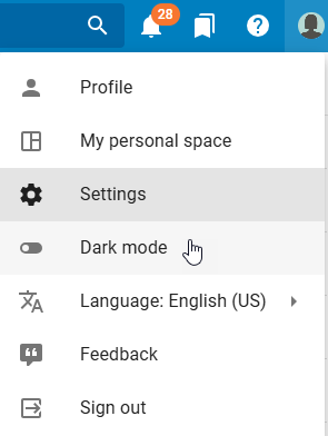

Tip: To quickly access your personal space, click your user icon > My personal space. If you do not have a personal space, you might be able to create one from your account settings if this option is enabled by JMP Live administrators.

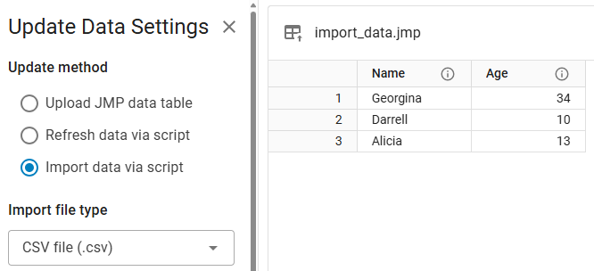

User can upload data that is not in a JMP format to JMP Live. During the upload process, the data is converted into a JMP data table.
Tip: Before a user can import data, a Data Admin must set the update method and create a script. See Create an Import Script.

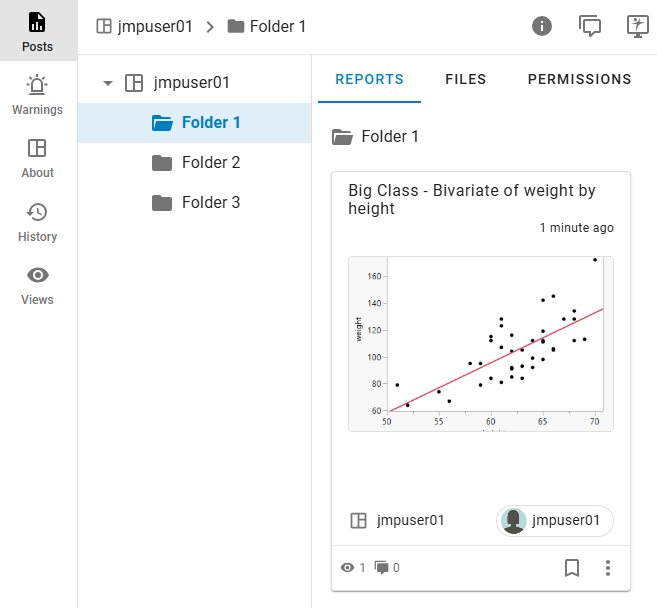

Open Content in a Space
You can open folders, report posts, or data posts in spaces where you have View permission.
In a space, click Posts Image shown here, and then:
Click a folder to open it.
Click the Reports tab to see all report posts in the folder or space. Click a report post to open it.
Click the Files tab to see all data posts, report posts, and any subfolders in the folder or space. Click a data or report post or folder to open it.
For more details, see Open a Post.

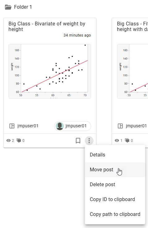

In a space, click Posts Image shown here.
At the upper right, click Image shown here to create a folder.
Add a title.
(Optional) Add a description.
5.
Click Create.
Notes:
Folder permissions are inherited from the space unless you set custom permissions on the folder. See Set Custom Permissions on a Folder.
Folders in spaces are sorted alphabetically ascending by title.

Move a Folder
You can move any folder for which you have Contribute permission. You can move folders within spaces, but not between spaces.
Click a folder.
Click Image shown here and then select Move folder.
Choose the space that you want to move the folder to.
Tip: You can choose a folder in the destination space to nest the folder under or create a new folder by clicking the Create folder Image shown here icon.
5.
Click Move.

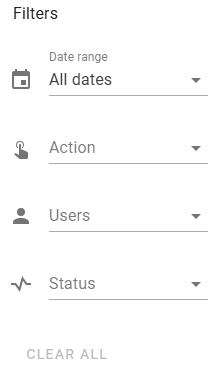

You can browse all history or limit your search using the filters.
Figure 1.3 Filter Options in History
In the filters, enter any combination of dates, actions, users, and whether the action succeeded or failed.

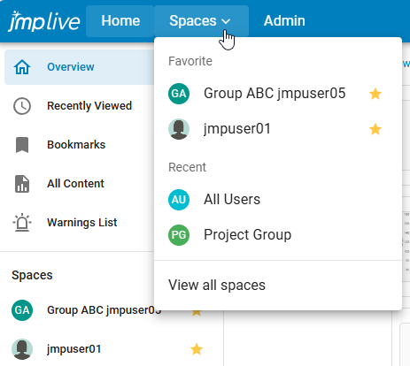

To quickly find spaces that you have access to, you can favorite them:
From the Home page or Space Directory, hover over a space and click Image shown here.
In a space, click About, and then click Favorite.
Tip: You can unfavorite a space in the same way.
Once you favorite a space, it appears at the top of the list in these areas:
under Spaces at left on the Home page
under the Spaces menu in the title bar
Figure 1.4 Favorites in the Home Page and Spaces menu

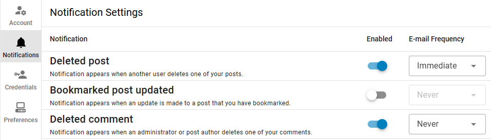

By default, you get a notification in the following situations:
if someone adds or replies to a comment on a post that you own
if someone @ mentions you in a comment
if someone replies to a comment that you made
if someone deletes a comment that you made

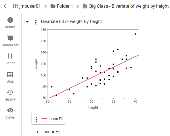

In a JMP Live report post, you can see information about data points in graphs or report calculations.
Click or tap Identify Objects (Image shown here).
Hover over or tap a data point or a calculation.
Figure 1.11 See a Data Point’s Values
Figure 1.12 See an Explanation of a P-Value Calculation

To hide or show a report or graph, click or tap the arrow next to the title.
If your report contains very large tables, use the page controls Image shown here

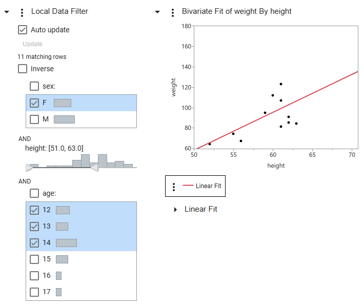

Click Auto Update to deselect this option.
Make your changes to the local data filter.
The graphs do not update as you make your changes.
Click Update.

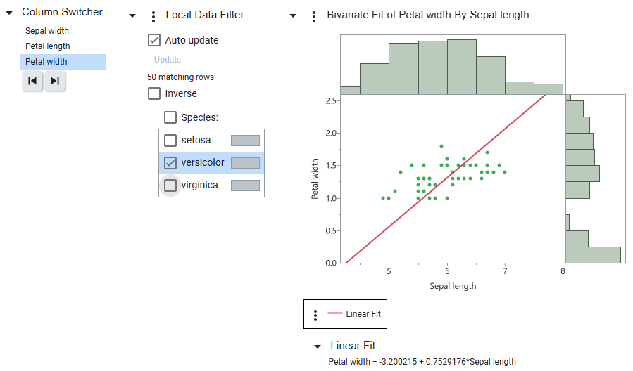

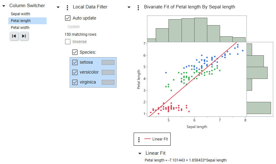

Switch Data Columns in Graphs
If the original JMP report included a Column Switcher, you can quickly analyze different variables without re-creating the analysis. When you choose a different variable in JMP Live, the analyses automatically recalculate using the new variable.
In the following example, using Fisher’s Iris data, the JMP report post includes a Column Switcher and a Local Data Filter.
Figure 1.17 Initial Selections
Initial Selections
Initially, Petal length (the original column) is selected in the Column Switcher. All species are showing in the Local Data Filter. These selections are reflected in the graph and calculations.
Figure 1.18 Updated Selections
Updated Selections
In this example, Petal width is selected in the Column Switcher, and only the species versicolor is selected in the Local Data Filter. The graph and calculations update to reflect these selections.
Tip: Selections that you make in the Local Data Filter and Column Switcher are captured in the URL. You can copy and paste the URL to share your selections with others.

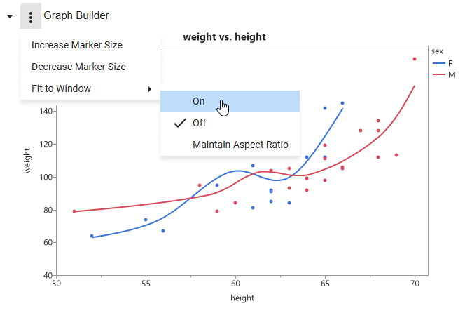

Customize Graphs
Note: These customizations are temporary while you are in the JMP Live post.
To resize a graph in JMP Live, click and drag on the graph borders. You can also resize a scrollable report in a JMP Live dashboard.
Use the options in the More Image shown here menu to customize graph elements.
Figure 1.19 Fit a Graph to the Window
You can increase or decrease the marker size for all graphs that include markers. For Graph Builder and Control Chart graphs, you can automatically size the graph based on your browser window size by turning on Fit to Window.
Note: The options in this menu vary depending on the type of graph or JMP platform.

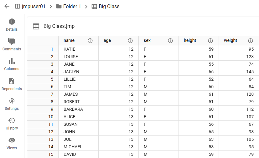

Open a Data Table
In a space or folder, click the Files tab.
Click a data post Image shown here.
Figure 1.20 Example Data Table
Example Data Table
Depending on your permissions, in addition to seeing details, adding comments, viewing the history, and seeing who has viewed the data, you can:

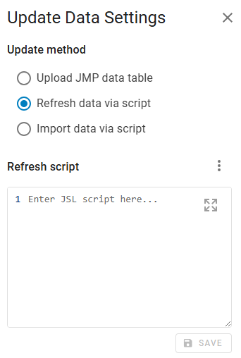

Create the refresh script
Click Settings Image shown here.
Select Refresh data via script as the update method.
Figure 1.21 Refresh Data Using a Script
5.
Create the refresh script. See Examples of Refresh Scripts.
6.
Paste your refresh script under Refresh Script.
7.
Click Save.

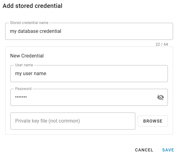

Add or Update Credentials
At the upper right, click your user icon > Settings.
From the left pane, click Credentials Image shown here.
To update the credentials:
Click Image shown here to edit the credentials. Update the credential name. Click Update credential to modify the user name and password.
Click Delete Image shown here to delete a credential.
Click Image shown here to add a new credential.
Figure 1.22 Add Your Stored Credentials
5.
Name the credential.
Tip: Use a name that helps you identify the credential, such as the name of the database.
6.
Enter a user name and password for the credential.
7.
(Optional) Upload a private key file.
Depending on your data source provider, some authentication processes require the use of a private key file.
8.
Click Save.

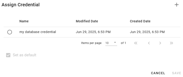

Assign Credentials
If any JSL commands in your refresh script require credentials to access an external server or database, you can securely add and assign those credentials. In the refresh script, your credentials are represented by generic placeholders (%_PWD_% and %_UID_%) and are not visible. When the refresh script runs, the script replaces the generic placeholders with the actual credentials.
Ensure that you have created a refresh script. See Create a Refresh Script.
Click Assign under Assigned Credentials.
Figure 1.23 Assign an Existing Credential
5.
Click Image shown here to create a new credential. See Add or Update Credentials. Or select the credential that you want to use.
6.
(Optional) Click Set as default to make the credential available in the refresh script.
7.
Click Save.

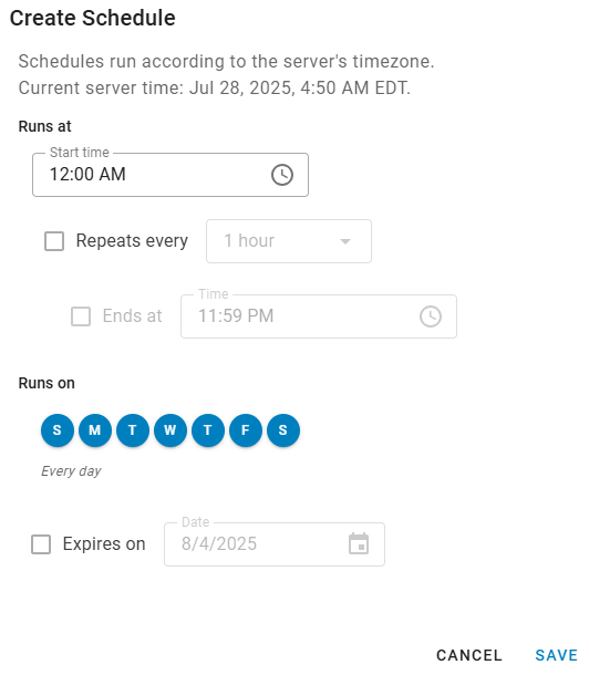

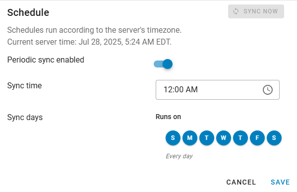

Schedule a Refresh
Scheduling a refresh requires Data Admin permission. You can schedule data to refresh as often as every 10 seconds or as infrequently as once per week. You can also have several schedules for a data post. For example, you might have one schedule to refresh the data every Tuesday at 9 p.m., and another schedule to also refresh the data hourly every Friday from 8 a.m. until 5 p.m.
Note: Schedules are based on the time zone that your JMP Live server is in.
Click Settings.
5.
Ensure that you create and store the credentials in JMP Live if your data comes from a third party and uses credentials. See Assign Credentials.
6.
Click Create next to Refresh Schedules.
Figure 1.24 Create a Refresh Schedule
7.
Select the following details:
Time for the refresh to start.
Days of the week to run the refresh.
(Optional) To repeatedly refresh data during a time period, specify how often to repeat the refresh and what time to stop refreshing the data.
(Optional) Set a date for the refresh to expire. The expiration date is inclusive, so the refresh expires at 11:59 p.m. on the day.
8.
Click Save.
9.
Under Refresh Schedules, you can enable, edit, or delete a schedule.

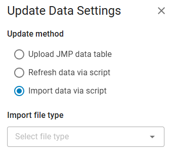

Create the import script
From a data post, click Settings Image shown here.
Select Import data via script as the update method.
Figure 1.25 Import Data Using a Script
Select the type of file that you want to import.
Create the import script using JSL.
5.
Paste your import script under Import script.
6.
Click Save.

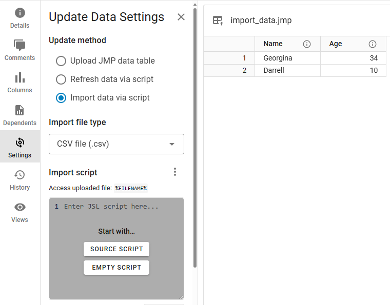

Example of Importing Data
In this example, you have a CSV file with names and ages. You open the file in JMP, which converts it to a JMP data table. You publish this JMP data table to JMP Live.
The data in the CSV file can change, so you want to update the data in JMP Live by importing the latest data from the CSV file.
From the data post, click Settings Image shown here.
Select Import data via script.
Select CSV file.
Figure 1.26 Importing Data from a CSV File
(Appears only if the data table contains a source script.) Click Empty Script.
5.
Paste a script, such as the following example.
Open(
	"%FILENAME%",
	columns(
		New Column( "Name", Character, "Nominal" ),
		New Column( "Age", Numeric, "Continuous", Format( "Best", 12 ) )
	Import Settings(
		End Of Line( CRLF, CR, LF ),
		End Of Field( Comma, CSV( 1 ) ),
		Treat Leading Zeros as Character( 1 ),
		Strip Quotes( 0 ),
		Use Apostrophe as Quotation Mark( 0 ),
		Use Regional Settings( 0 ),
		Scan Whole File( 1 ),
		Treat empty columns as numeric( 0 ),
		CompressNumericColumns( 0 ),
		CompressCharacterColumns( 0 ),
		CompressAllowListCheck( 0 ),
		Labels( 1 ),
		Column Names Start( 1 ),
		First Named Column( 1 ),
		Data Starts( 2 ),
		Lines To Read( "All" ),
		Year Rule( "20xx" )
6.
Click Save.
7.
Click Import Data.
8.
Open the updated CSV file on your computer.
9.
Click Reload.
Figure 1.27 Updated Data from CSV File
Notice that the data is updated and includes an additional name.

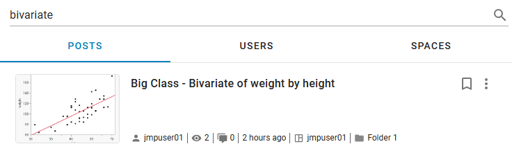

Search JMP Live
To find posts, users, or spaces across JMP Live, enter a keyword in the search box. Click Posts, Users, or Spaces to see specific types of results.
Figure 1.28 Example of Searching by Keyword
Here are some actions that you can take from the search results:
Posts
To open a post, click the title or image.
To open the post author’s profile, click their user name.
To open a space or folder, click the space or folder title.

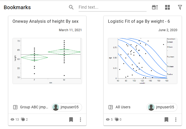

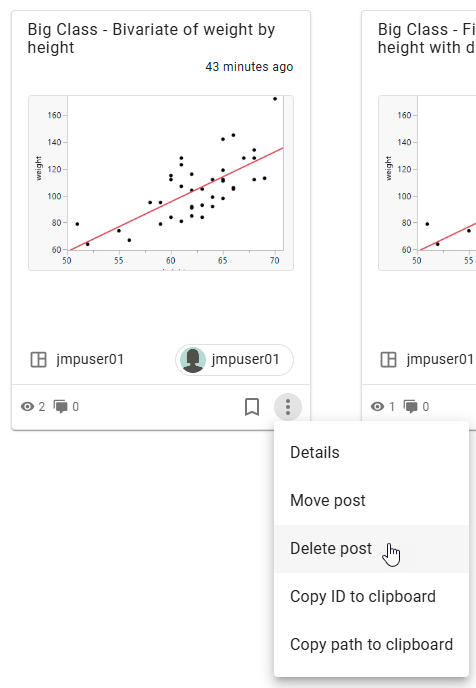

To bookmark a post, click Image shown here.
To copy the post ID for scripting, click Image shown here > Copy ID to clipboard.
To move or delete a post that you own, click Image shown here > Move post or Delete post.

Change the Theme to Dark or Light Mode
To change the theme from light mode to dark mode, at the upper right, click your profile picture > Dark mode.

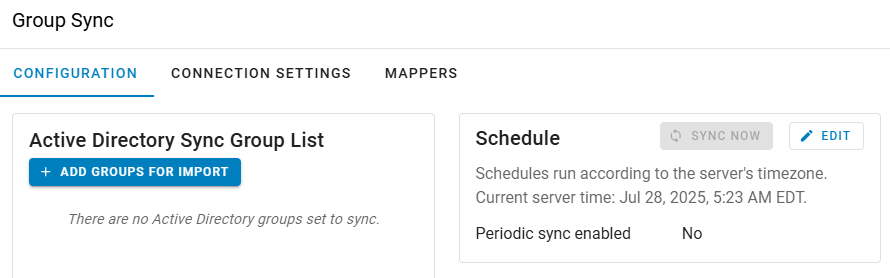

Sync Groups from Microsoft Active Directory to JMP Live
Enter the Active Directory Settings
Click Admin > Sync .
Click Connection Settings.
Enter your Active Directory server settings.
Figure 1.32 Example of Connection Settings for the Active Directory
Click Test Connection to ensure that the settings are correct.
Map Attributes
Mappers tell JMP Live which Active Directory attribute to use for a particular JMP Live attribute.
Click Mappers.
Enter the details that map your Active Directory attributes to JMP Live attributes.
Note: It is important to map the correct attributes based on your Active Directory configuration and authentication configuration.
Figure 1.33 Example of Mappers for the Active Directory
Find and Sync Groups
Click Configuration.
Click Add Groups for Import.
Figure 1.34 Add Microsoft Groups
Enter text to search for the groups that you want to add.
This searches by substring in Active Directory and by prefix in Entra ID.
Click Search.
5.
Select the groups that you want to add.
6.
Click Submit.
7.
Click Sync Now to perform the initial sync to get all groups and users.
Note: This process can take time, depending on the size of the initial synchronization.
8.
(Optional) Schedule a periodic sync to keep groups and users in sync with any changes made in Microsoft:
a.
Click Edit.
b.
Turn on Periodic sync enabled.
Figure 1.35 Schedule a Microsoft Sync
c.
Choose a time and day to run the sync. You can choose multiple days.
d.
Click Save.
9.
