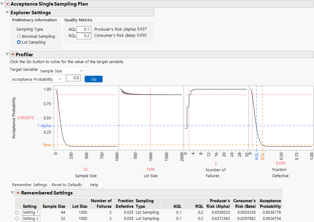

Example of the Acceptance Single Sampling Plan Explorer
In this example, use the Acceptance Single Sampling Plan Explorer to explore the difference in sample sizes for two acceptance probabilities for a specified sampling plan. For a lot of size 1,000, allow 1 failure, and assume a fraction defective of 0.035.
1. Select DOE > Sample Size Explorers > Quality > Single Sampling Plan.
2. Leave Sampling Type set to Lot Sampling.
3. Leave AQL and RQL set to the defaults.
4. Leave Target Variable set to Sample Size.
5. Leave Acceptance Probabilty set to 0.80.
6. In the profiler, set Lot Size to 1000.
7. In the profiler, set Number of Failures to 2.
8. In the profiler, set Fraction Defective to 0.035
9. Click Go.
10. Click Remember Settings to save the results showing that 44 samples are needed for an 80% acceptance probability for the specified sampling plan.
11. In the window, leave the default name and click OK.
12. Set the Acceptance Probabilty to 0.90.
13. Click Go.
14. Click Remember Settings to save the results showing that 32 samples are needed for a 90% acceptance probability for the specified sampling plan.
15. In the window, leave the default name and click OK.
Figure 29.14 Acceptance Single Sampling Plan Explorer
Compare the 32 and 44 sample sizes in terms of producer and consumer’s risks. The larger sample size has a higher producer’s risk and a lower consumer’s risk.
