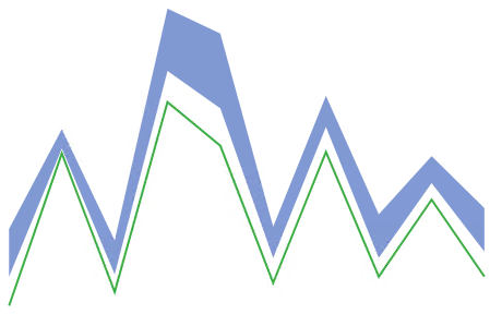

Range
Shows the area that corresponds to the difference in the summary statistic for the merged variables.
Image shown here
