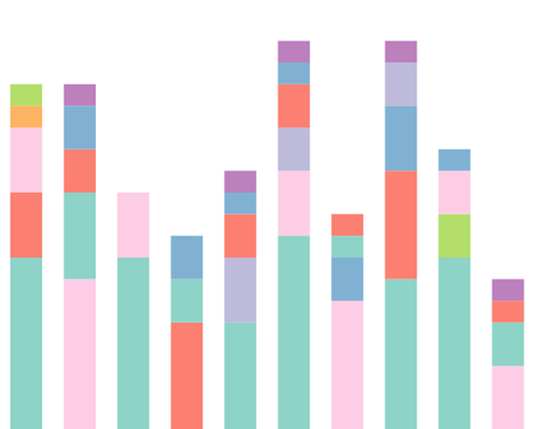

Stacked
When you have two or more merged variables on the response axis, a single bar is plotted for each level of the stratifying variables. Each bar stacks the bars for each of the merged variables. The part of the bar that corresponds to each merged variable is colored, and a legend appears.
Image shown here

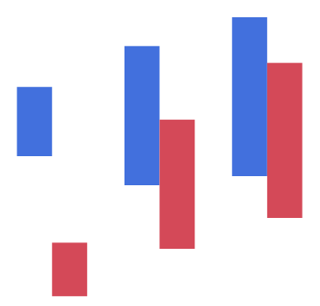

Image shown here

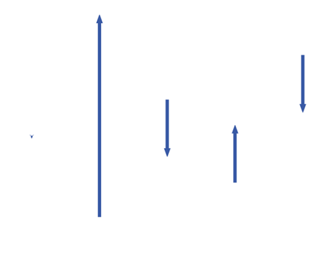

Arrow
This bar style uses arrows to represent directional change or movement between two points in time, categories, or variables. This option is useful when analyzing the rate of change over different time intervals.
Image shown here

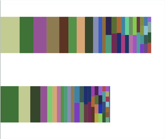

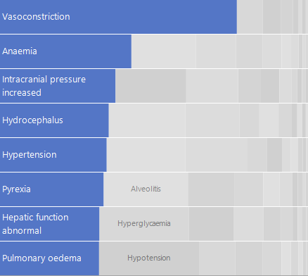

Packed
This bar style shows the top categories as a bar chart and stacks the other categories as bars with an approximately rectangular fill. The top categories are the focus, and the other bars provide context.
This style is useful when you have many categories and skewed response data.
Image shown here
