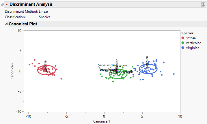

Figure 5.7 shows the Canonical Plot for a linear discriminant analysis of the data table Iris.jmp. The points have been colored by Species.
Figure 5.7 Canonical Plot for Iris.jmp
The biplot axes are the first two canonical variables. These define the two dimensions that provide maximum separation among the groups. Each canonical variable is a linear combination of the covariates. (See Canonical Structure.) The biplot shows how each observation is represented in terms of canonical variables and how each covariate contributes to the canonical variables.

For the Iris.jmp data, there are three Species, so there are only two canonical variables. The plot in Figure 5.7 shows good separation of the three groups using the two canonical variables.
The rays in the plot indicate the following associations:
• Petal length is positively associated with Canonical1 and negatively associated with Canonical2. It carries more weight in defining Canonical1 than Canonical2.
• Petal width is positively associated with both Canonical1 and Canonical2. It carries about the same weight in defining both canonical variates.
• Sepal width is negatively associated with Canonical1 and positively associated with Canonical2. It carries more weight in defining Canonical2 than Canonical1.
• Sepal length is negatively weighted in terms of defining Canonical1 and very weakly associated in defining Canonical2.

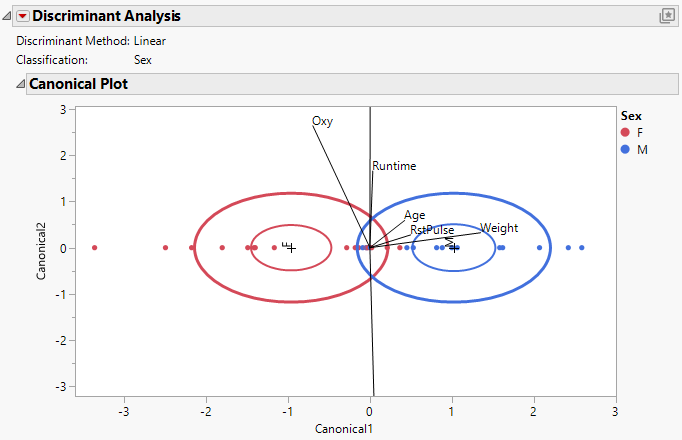

Figure 5.8 shows a Canonical Plot for the sample data table Fitness.jmp. The seven continuous variates are used to classify an individual into the categories M (male) or F (female). Since the classification variable has only two categories, there is only one canonical variable.
Figure 5.8 Canonical Plot for Fitness.jmp
The points in the Canonical Plot have been colored by Sex. Note that the two groups are well separated by their values on Canonical1.
Although the rays corresponding to the seven covariates have a vertical component, in this case you must interpret the rays only in terms of their projection onto the Canonical1 axis. Note the following associations:
• MaxPulse, Runtime, and RunPulse have little association with Canonical1.
• Weight, RstPulse, and Age are positively associated with Canonical1. Weight has the highest degree of association. The covariates RstPulse and Age have a similar, but smaller, degree of association.
• Oxy is negatively associated with Canonical1.
