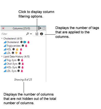

The More Column Filtering Options button Image shown here provides additional options for managing columns in the data table columns list, the Platform Launcher columns picker, and the data grid. This helps you find and focus on columns of interest.
Use Image shown here to filter the columns in the data grid by tags, show hidden columns, and filter the data table.
Figure 5.15 Example of a Columns Panel with Filtering OptionsĀ
