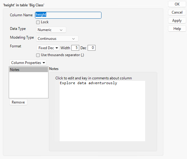

Use the Column Info window and the Columns Manager to set specific properties on a column in a data table. Here are some examples of the actions that you can perform on a column:
• Change data and modeling types
• Change numeric formats
• Add formulas
• Specify restrictions on values or missing values
• Order categorical values or row data
• Save specification, control, or response limits
• Add a tag
You can also standardize attributes and properties across multiple columns, assign a preselected analysis role to columns, and compress columns in a data table.
Figure 5.1 The Column Info Window
