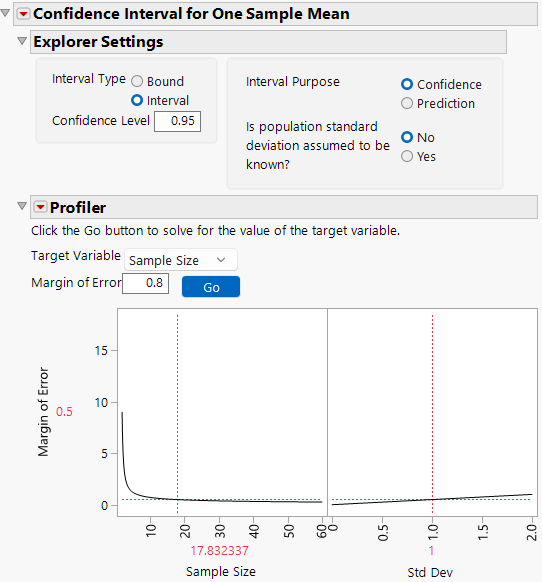

Example of the Confidence Interval for One Sample Mean Explorer
In this example, use the Confidence Interval for One Sample Mean Explorer to calculate the sample size that is needed to estimate a mean within 0.5 standard deviations with 95% confidence.
1. Select DOE > Sample Size Explorers > Confidence Intervals > Confidence Interval for One Sample Mean.
2. Leave Interval Type set to Interval for estimating a sample size for a two-sided confidence interval.
3. Leave Confidence Level set to 0.95.
4. Leave Interval Purpose set to Confidence.
5. Leave the population standard deviation assumption set to No.
The sample size is calculated using the t distribution.
6. Leave Target Variable set to Sample Size.
7. Set Margin of Error to 0.5.
8. In the profiler, set Std Dev to 1.
9. Click Go.
Figure 29.8 Confidence Interval Explorer for One Sample Mean
To estimate the mean within 0.5 standard deviation units requires 18 samples. The actual size of the confidence interval depends on the observed standard deviation. Calculating in standard deviation units is a way to estimate sample size without assuming a standard deviation.
